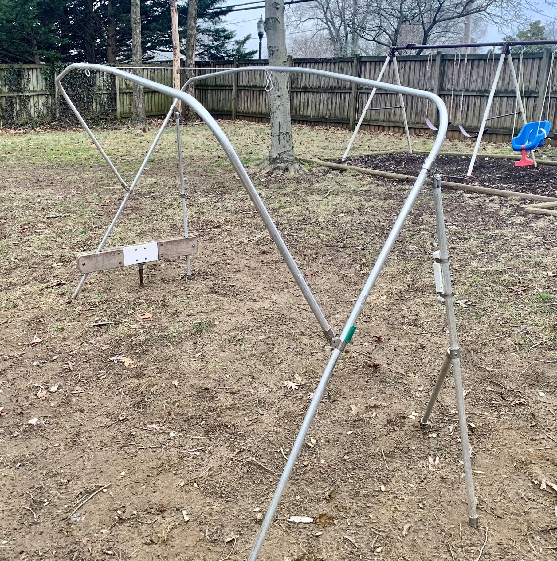

I recently got a frame, but am looking to buy/make a top for an aft Bimin (see picture).
Any one have a source, an old one, pattern for such an animal for my 1990 32 Sedan?

I have a friend in the marina with a heavy duty machine who made a nice top for his Sea Ray.
Here is the frame I picked up a few years ago off an earlier M. I believe it will fit well.
I can’t remember if the stantions sat in the deck or the aft cockpit aluminum bulkhead caps.
I also can’t remember how the canvas made up to the flying bridge deck.

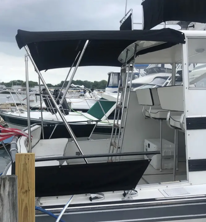

I have one on my 79 32 sedan bridge and could get you some measurements when it warms up a bit. The way mine connects is by snaps
[/img]
