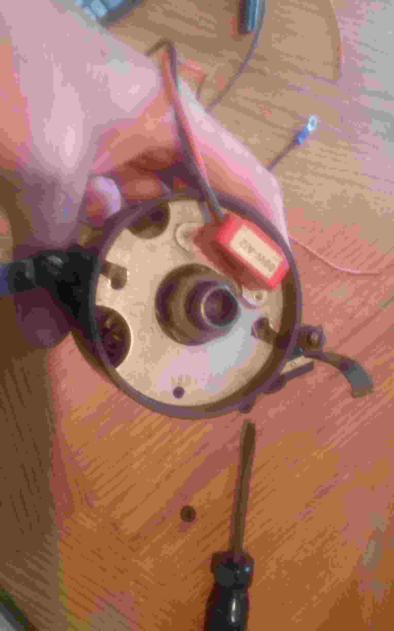

Used the under cap conversion kit rather than the full distributor replacement (because of the fit issue described in earlier posts)
So far, it has made a big difference.
The correct part number for the 318 is: 91581

That's really odd my ignitor 2 that came with my boat was cut like the photo. I ordered the same part number 1581 and had to cut it the same way. My thing that spins round and make fire 8 times per revolution ( assie for dizzy) has been sent to pertronix maybe they can solve the mystery.
