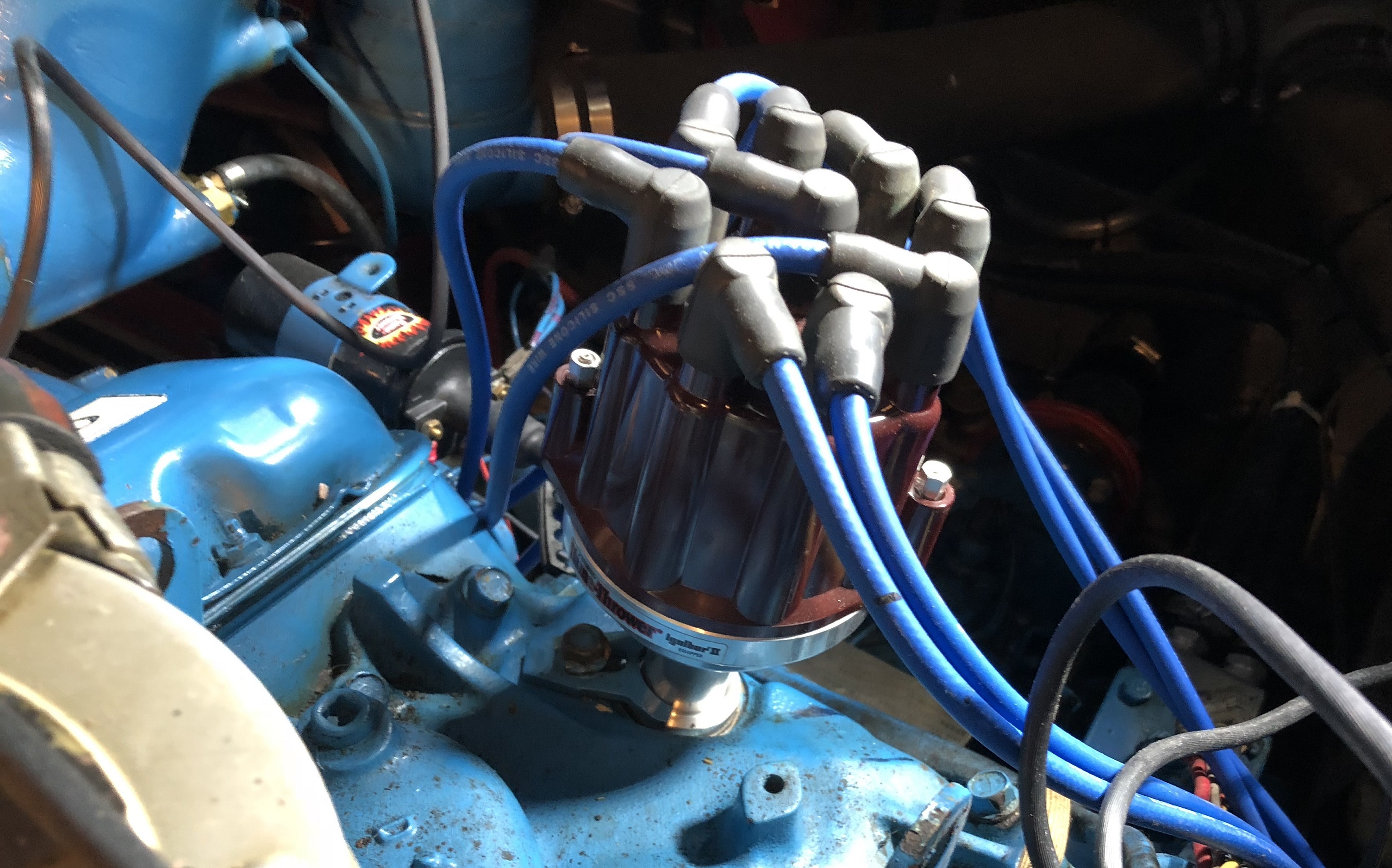

I am planning to take the boat on the water down to Catawba Island on Lake Erie. I will truck it from there to Marietta,OH to keep on the Ohio River. I hope to have schedule set up in the next day or so.
The seller installed new Pertronix FlameThrower electronic distributors and new hot coils installed last year. Here is a pic...

Glad to hear you have the new petronix coil and ignition module. I have those as well. If you find your idle does not always return to the same level, check the mechanical advance weights and springs in the distributor for rust. I had to clean the weights and springs for flawless performance. I am also going to buy new spring kits while they are still available -- just in case. As the springs rust, the diameter of the spring wire decreases and the spring tension does too.
Paul

You'e description sounds like part of why the seller replaced the old distributors...
