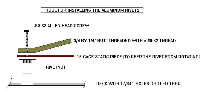

Jeff, I guess I don't understand. Did you have to get to the back side & use an extra nut to smash the threaded rivets?

Can't find the sketch I made.
Study the right photo. That small piece of metal (4 x 2 inch) with a hole drilled in one end is the "handle". The Allen bolt goes into a nut, then through the "handle", then into the Rivet Nut.
Place the Rivet Nut, handle and bolt assembly in the hole in the deck, hold onto the "handle" so it won't turn and tighten the nut (on the Allen bolt. Sometimes you'll need to also have to stop the Allen bolt from turning until the Rivet Nut starts to seat.)
It's far easier to do than to describe!

Jeff,
This the drawing you mentioned?
