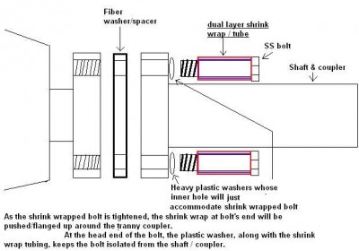

>> coupler passes the bolts through but they screw into the flange. Makes the heat shrink impossible.
Actually, you may be able to do the shrink tube...

John Althouse had them but, sadly, I don't think he can supply for a while at least. Meanwhile, the diagram above should be good guidance for everyone.yooper wrote:It would be nice if I could order a kit that has all the non-conductive elements in it. Kind of like a gasket set you can buy for an engine.
