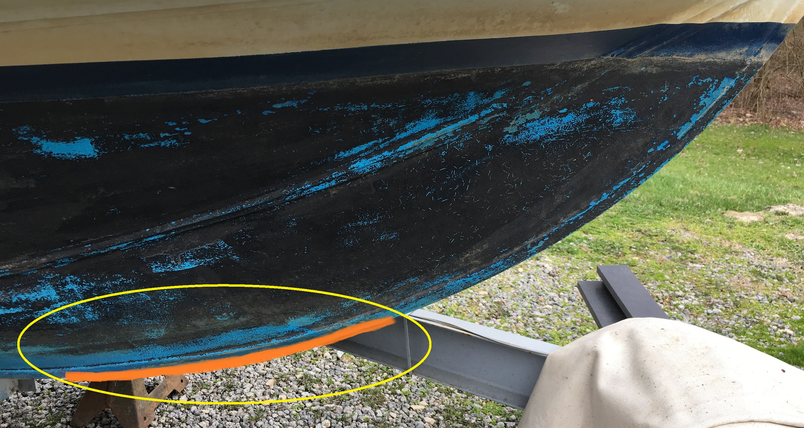

I've found that I have bare aluminum showing about 18" along the bow keel.  This could be from me pulling into a sandy beach area a couple of times last season.  If I sand this area and paint it with 3 or 4 coats of Interlux's Interprotect 2000E, will this paint act as a tough barrier or "keel guard" or will this likely occur again?  I will top the 2000E with Interlux 33.
Re: Hull Preparation & Painting
You're asking too much of paint.  It's not there to protect a very exposed surface (and a pointy one at that) from beachings.  Either accept that running the boat onto land will scour the surface or find a product (they are out there) to cover the keel.  Bottom paint exists to thwart algae and critters that want to attach to the hull, not as a guard against abrasion. Nor is it designed to ward off galvanic action though it helps a wee bit
I figured the 2000E wasn't super-magic-hardcoat paint.  I got a dinghy last year to get back & forth to the islands so that I would scrap the hull.  This year we have a sea-doo also.  We'll anchor out.
Somebody makes a plastic keel protector deal that attaches to the keel. (Forget the manufacturer.)  Supposed to eliminate that problem.
I looked into the "keel guard" products.  I was concerned about it bending & wrapping around with our sharp deep keels.  All the installations that I saw were on fiberglass like hulls.
An epoxy coating will hold up much!!!  better than anti fouling in a beaching situation.  I have a friend who used an epoxy that was sold for water tower interior liners and it was amazing at staying put after all the anti fouling was worn off from beaching. I have 2000E on mine but have not beached my boat enough to advise if it is as effective as what he used but I have hopes is it. I would also guess that muddy mucky Ohio beaches are less abrasive than the nice sand I wish we had...

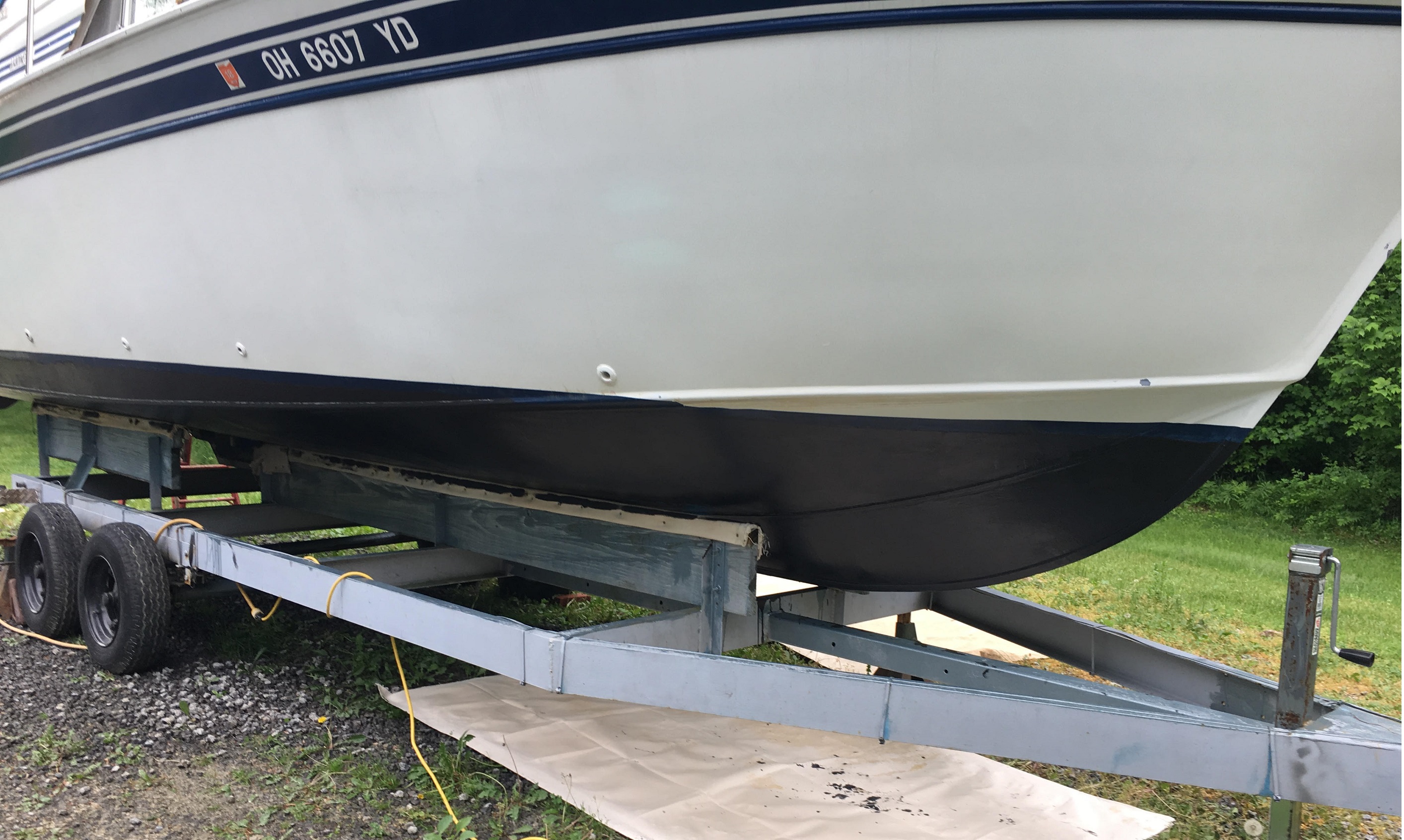

I finally got some time from work and decent weather to get the first coat of bottom paint done.
It's so late to not be in the water yet...
