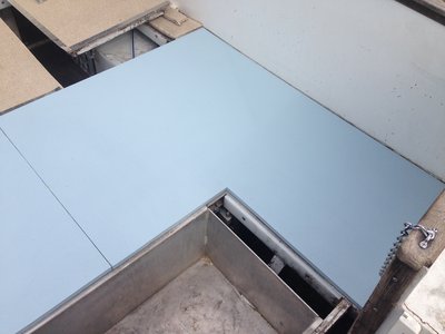

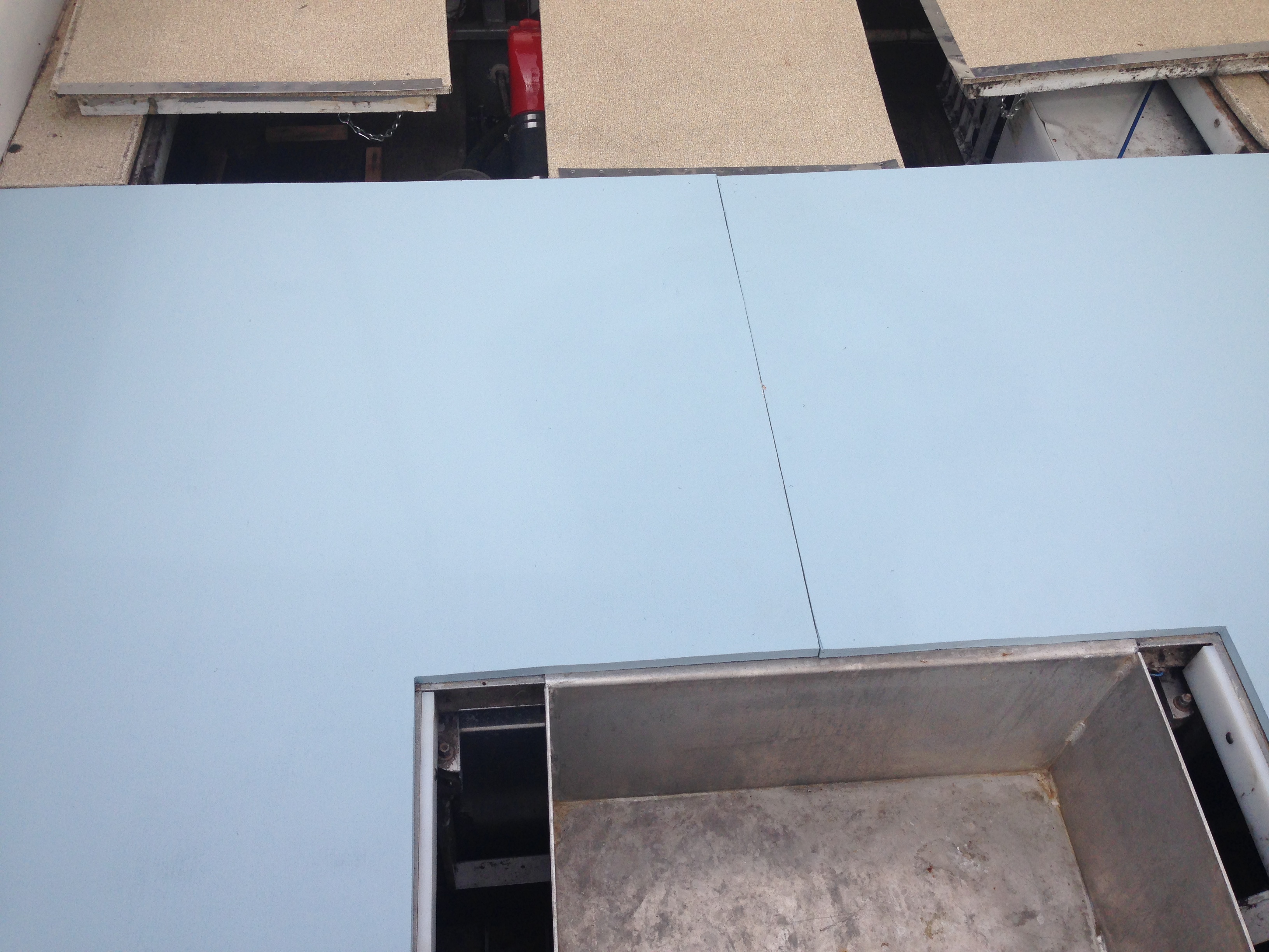

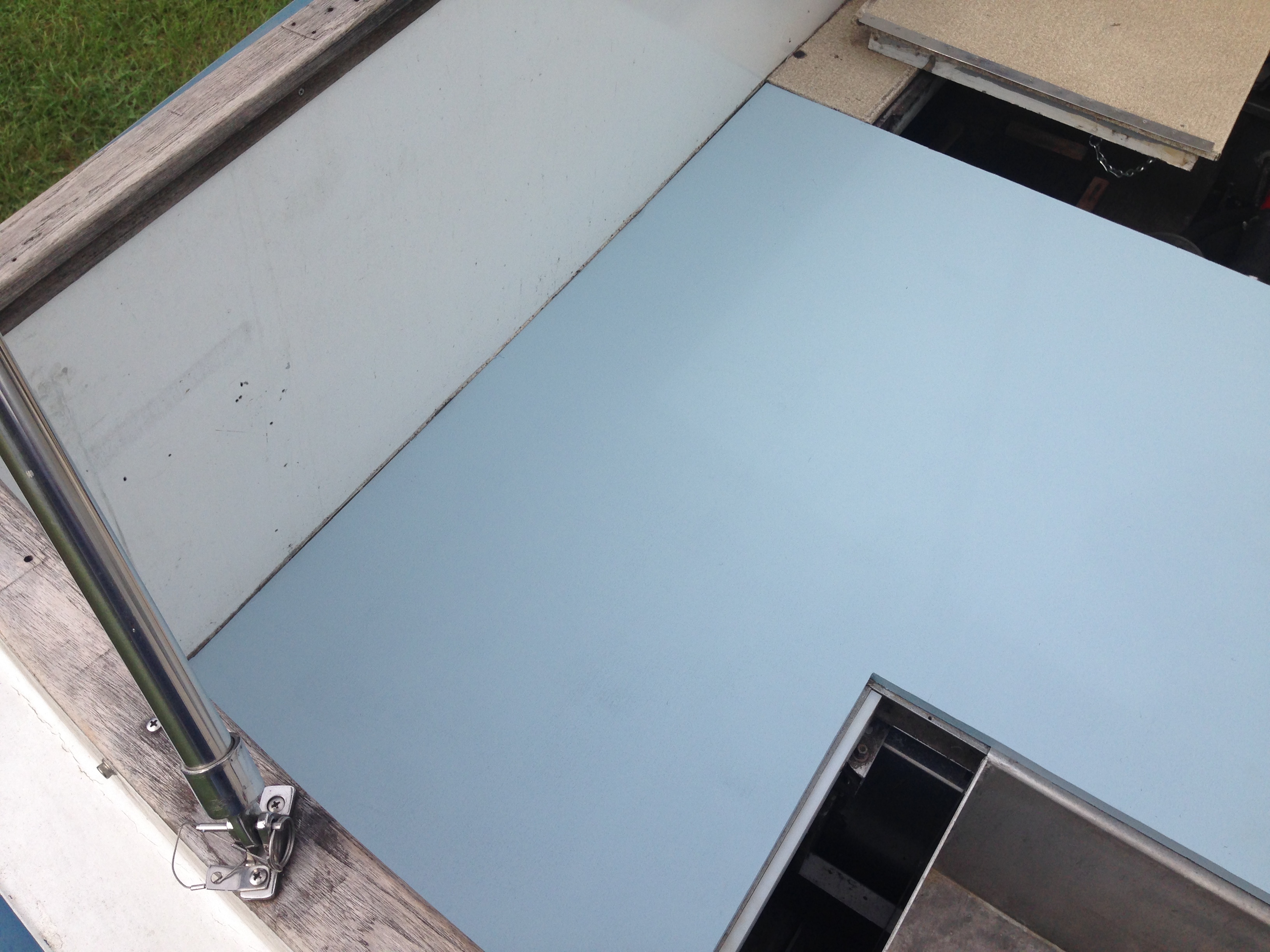

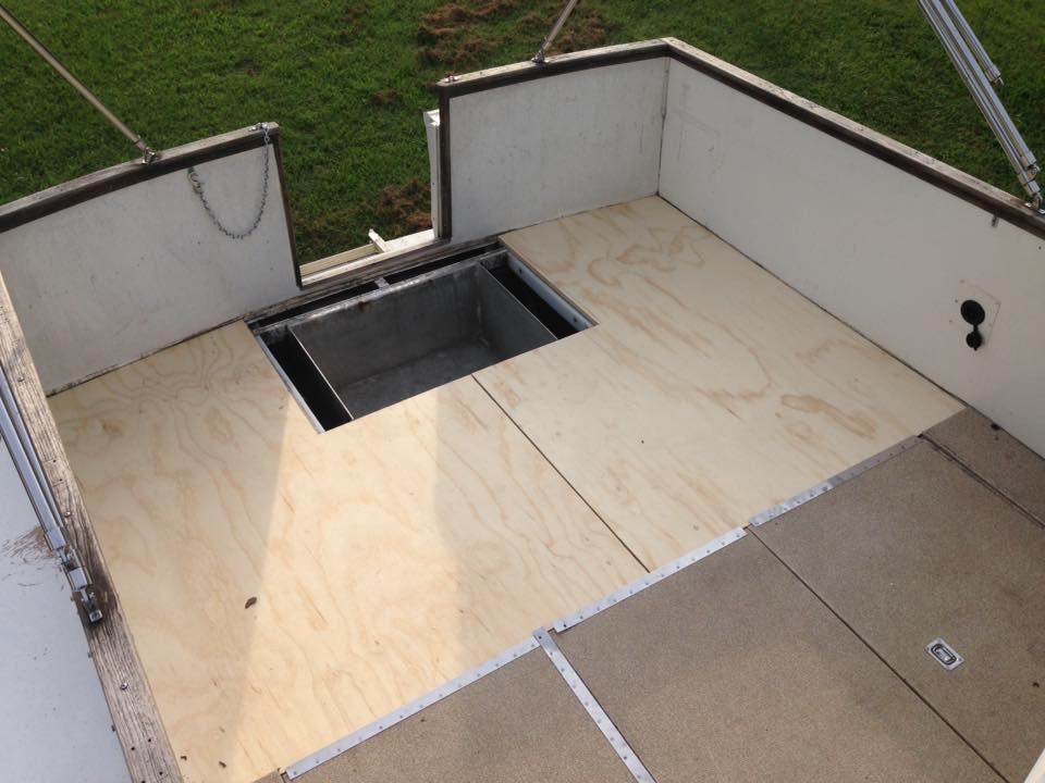

Cut new plywood decking from 5/8" exterior plywood. Had a pickup bed sprayer spray and underlap the bottom side by 6". Replaced the big washer on the cockpit drains with a big 1/4" aluminium flage that fits under the corner side walls. Tighten the cockpit drain nut and the deck is tightened down in the corners. Only put back the under deck screws I could reach.
