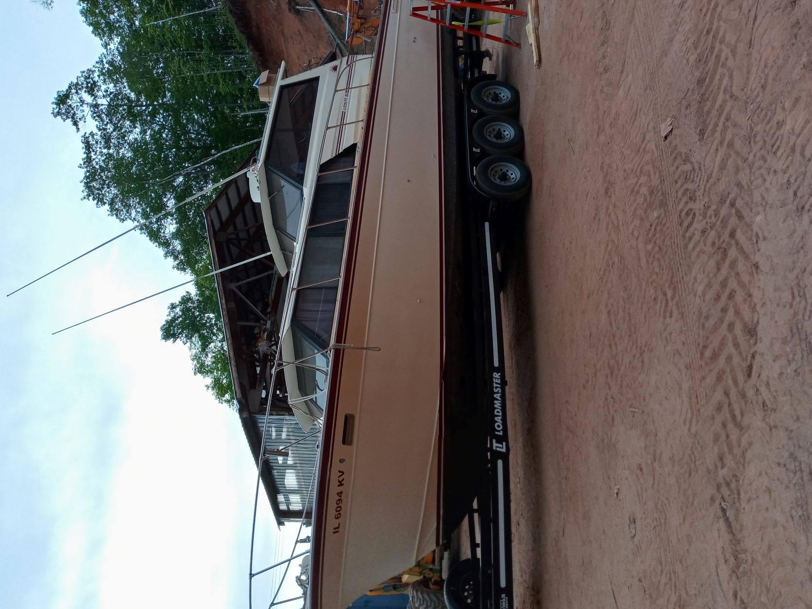

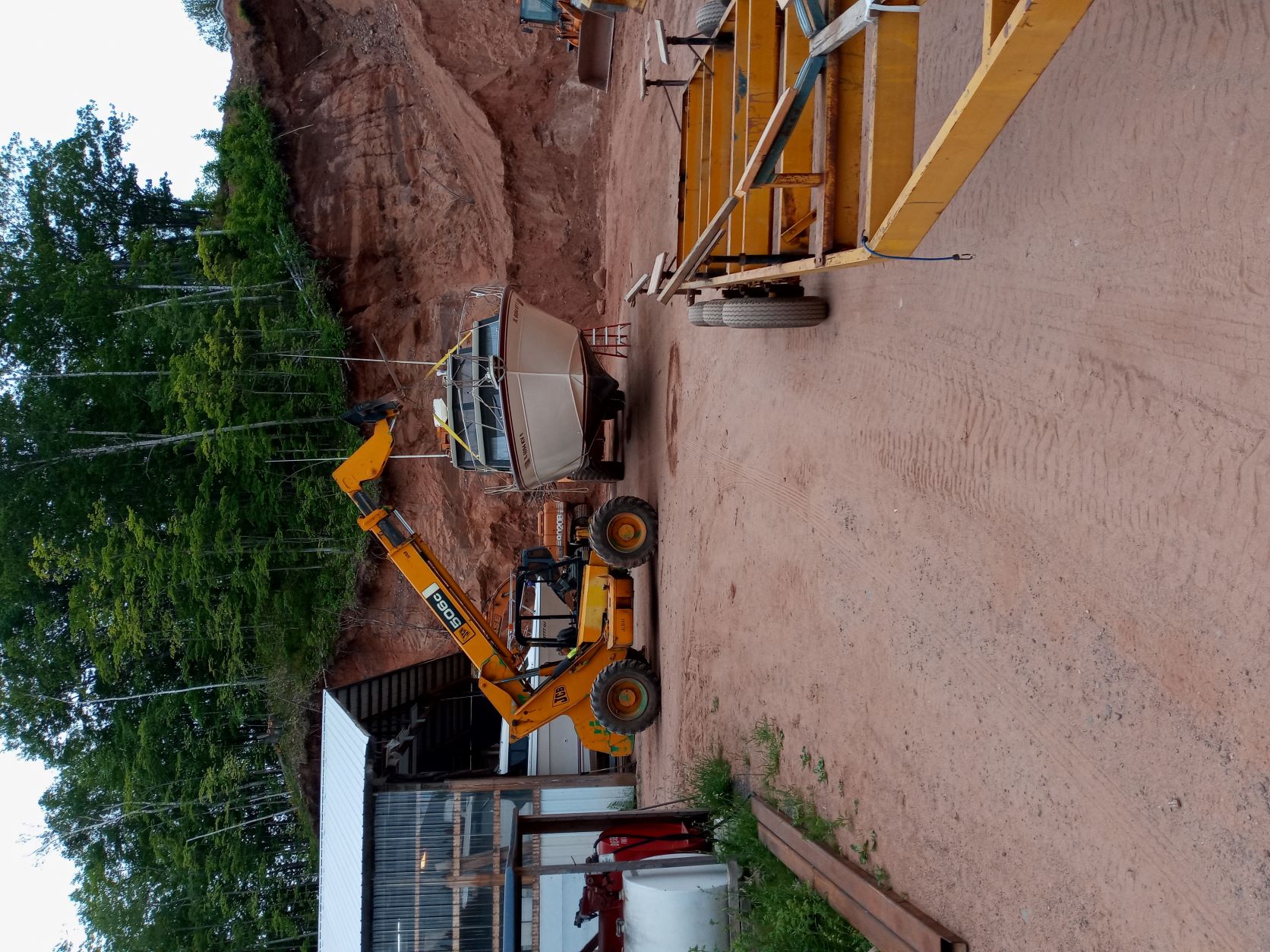

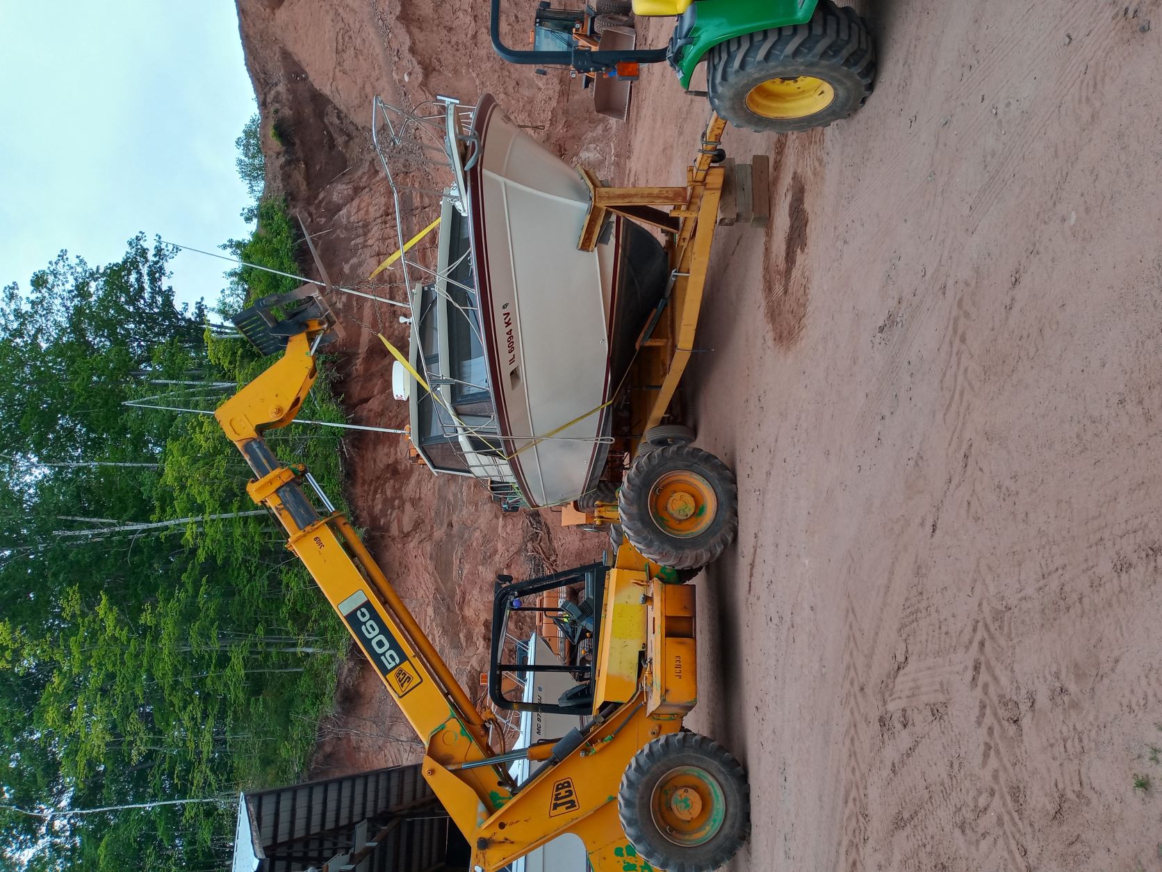

Swapped trailers under boat. Borrowed a buddies trailer for it to sit on after the engines go in. Old trailer was too short and did not support the stern at all. We used a fork lift, loader and a couple tow straps to and it for the swap.

Sitting on better trailer until I can lengthen the old one.

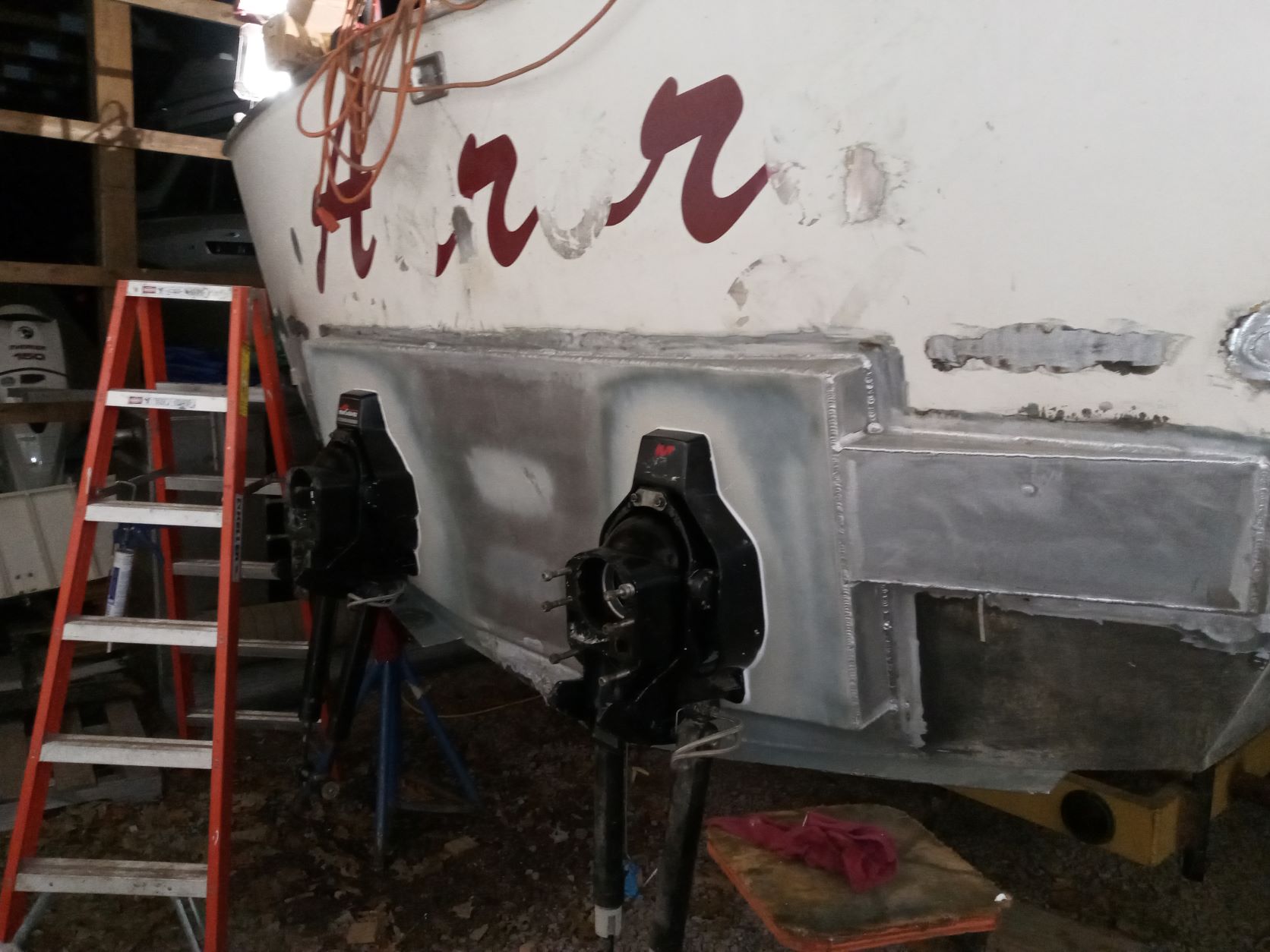

Transom assemblies installed for the last time I hope!

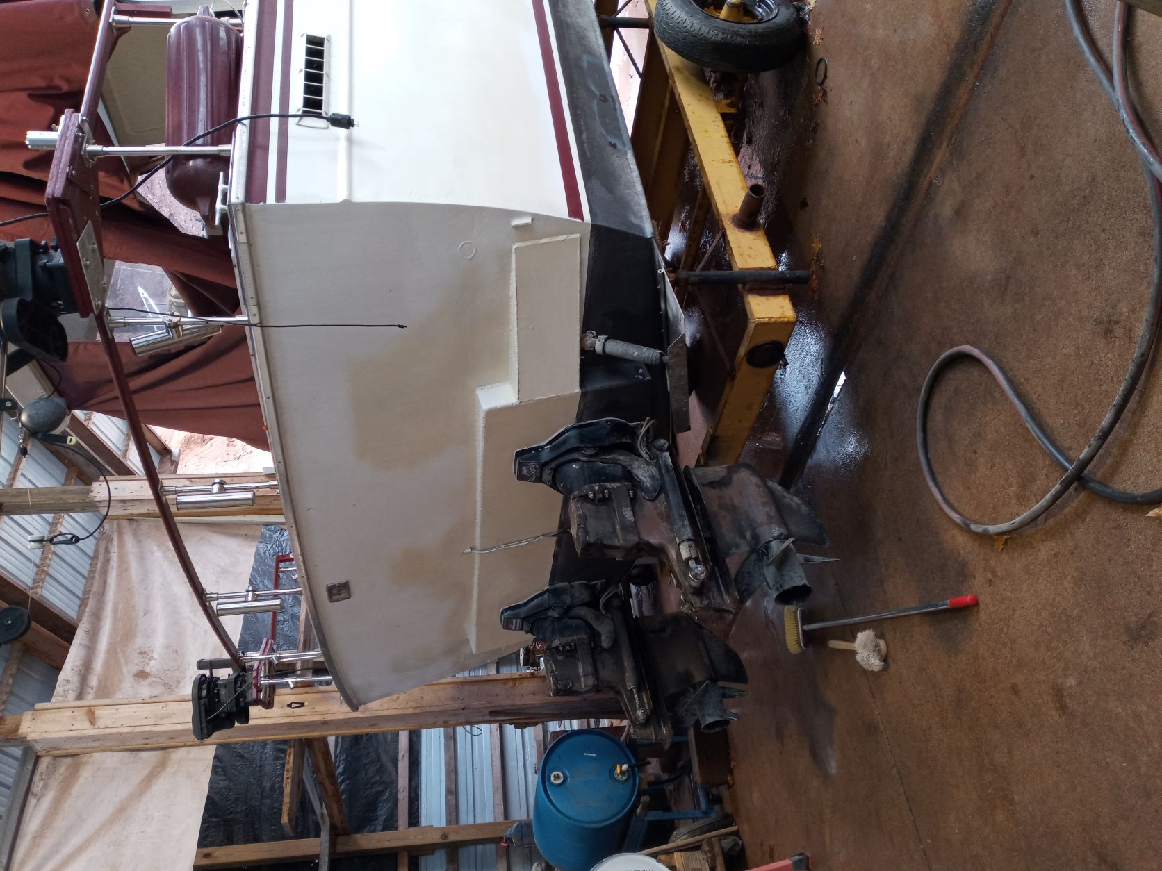

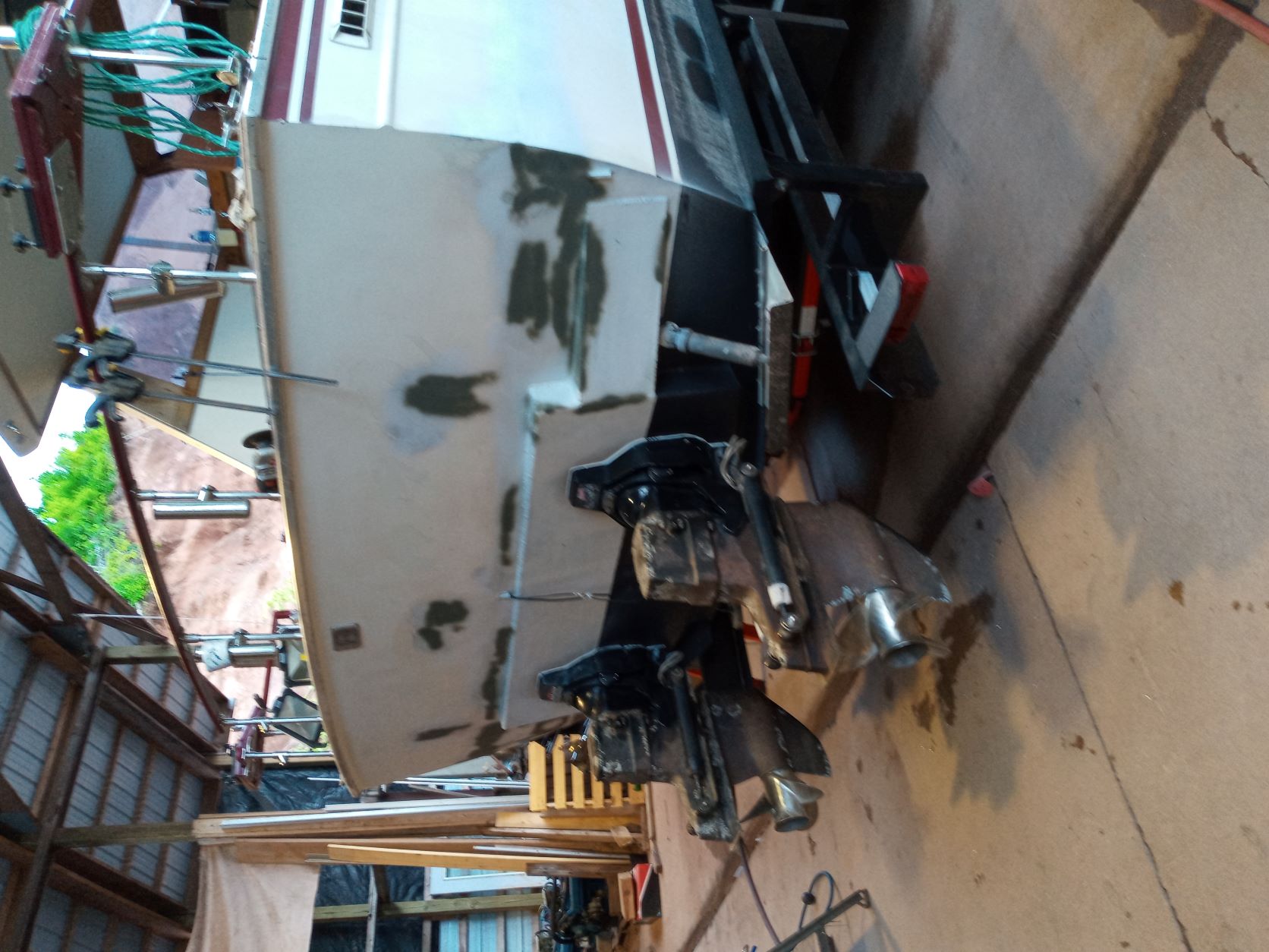

Engines mounted, transom assemblies installed, engines aligned, outdrives installed. Slapped some primer on the bare metal.

Re: A little crazy?
Have you tried the Fastjeff jump on the cavitation plate to see if it moves test?
TinLizzy
- Posts: 270
Re: A little crazy?
Jeff, the transom has passed the jump method, and the full throttle method. Both passed with flying colors. The welder and a couple engineers that looked it over were quite confident in the end product.

Paint job is quite bad, I had run out of time to get a decent color match. So I just slapped some paint on it before the launching to cover up the primer. Next spring I plan on repainting the whole boat from the rub rail down to the bottom paint.
