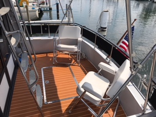

Welcome! I used 5/8” marine grade plywood and covered with “Lonseal” vinyl covering. I was able to use the old pieces as patterns, and apply the covering at home, then drop them in and screw them back down in the spring.
