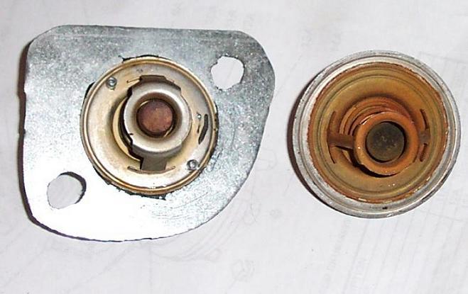

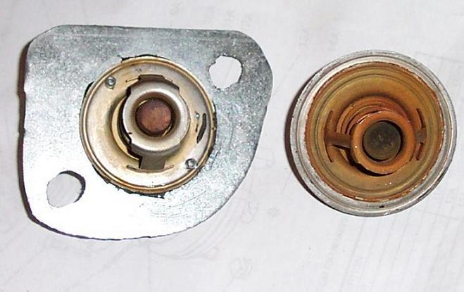

Re: Thermostat Housing
I assume your housing is so rotted the water bypasses the t-stat around the edges.
Had that problem with mine and solved it by making a "gasket" out of stainless steel, glue and riveting the t-stat to it, and using two gaskets. Worked perfectly!
