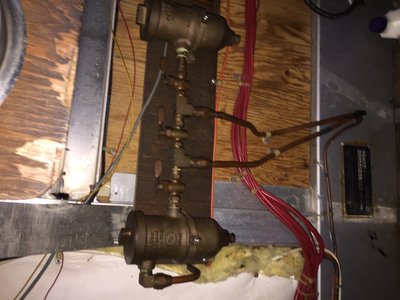

Hello All,
Still learning the system of my M39DC. When fueling up I always have equal amounts of gas into both tanks. I noticed that the port tank is reading 3/4 full and the starboard tank is 1/16 full or less yesterday. The tank under the bed looks like one big tank but with two opening for gas on deck I would assume two tanks below. I can tell the boat has a slight list to port I am assuming from the port gas tank. There are three gas valves in the engine compartment with all three inline and open. So, question is to my fellow Big M's, what am I missing? Does the port tank free flow to the starboard? Could the fuel pickup in the port tank be faulty or some other item that I am missing? Thanks in advance. Photo of gas valve is hopefully attached.
Kim

From the picture it shows you have selected to fuel any engine from any tank.I run mine with the middle valve closed so as to run fuel from port tank to port engine and starboard to starboard only

Another factor at play here might be that the engines are burning fuel at different rates - that would account for fuel gauge differences.
Also, list may be due to water tank - is it on the port side? At 8lbs / gal times x gals, that could be weighty enough to cause a little list.

My fear is that the pickup on the port tank is not working and if I ignore this fat dumb and happy, I might run out of gas. I also thought there might be some other valving or tank selector that I was unaware of at the helm. Guess my next trouble shooting project will be to close the starboard valve, start her up and see what happens.

On my 32, I noticed that the generator can only take suction on the starboard tank. That would also explain the tanks not going down evenly.

More than likely different resistance in the port and starboard supply lines resulted in the one side being favored. Now you have to find out why. There"s been lots of posts on here about cleaning the tanks and anti-siphon valves and servicing the water separators.
