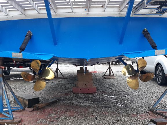

Re: 1:1 vs 1.5:1
Did this last year. I did move from 1" to 1 1/4" prop shafts. Trannys are 1.91 : 1. I have 18 x 16 4 blade props. I think the challenge is it is tough to fit a large enough prop. 18" is tight with respect to underside of boat and rudders. I am happy with the performance though. I wish I would have had 1.5 to 1 trannys.

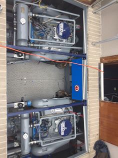

Re: 1:1 vs 1.5:1
What motors are you running with that? That looks amazing.
Todd
1983 32’ SedanFlybridge
Twin 318 Chryslers.
Twin 318 Chryslers.
Re: 1:1 vs 1.5:1
Small black Chevys
