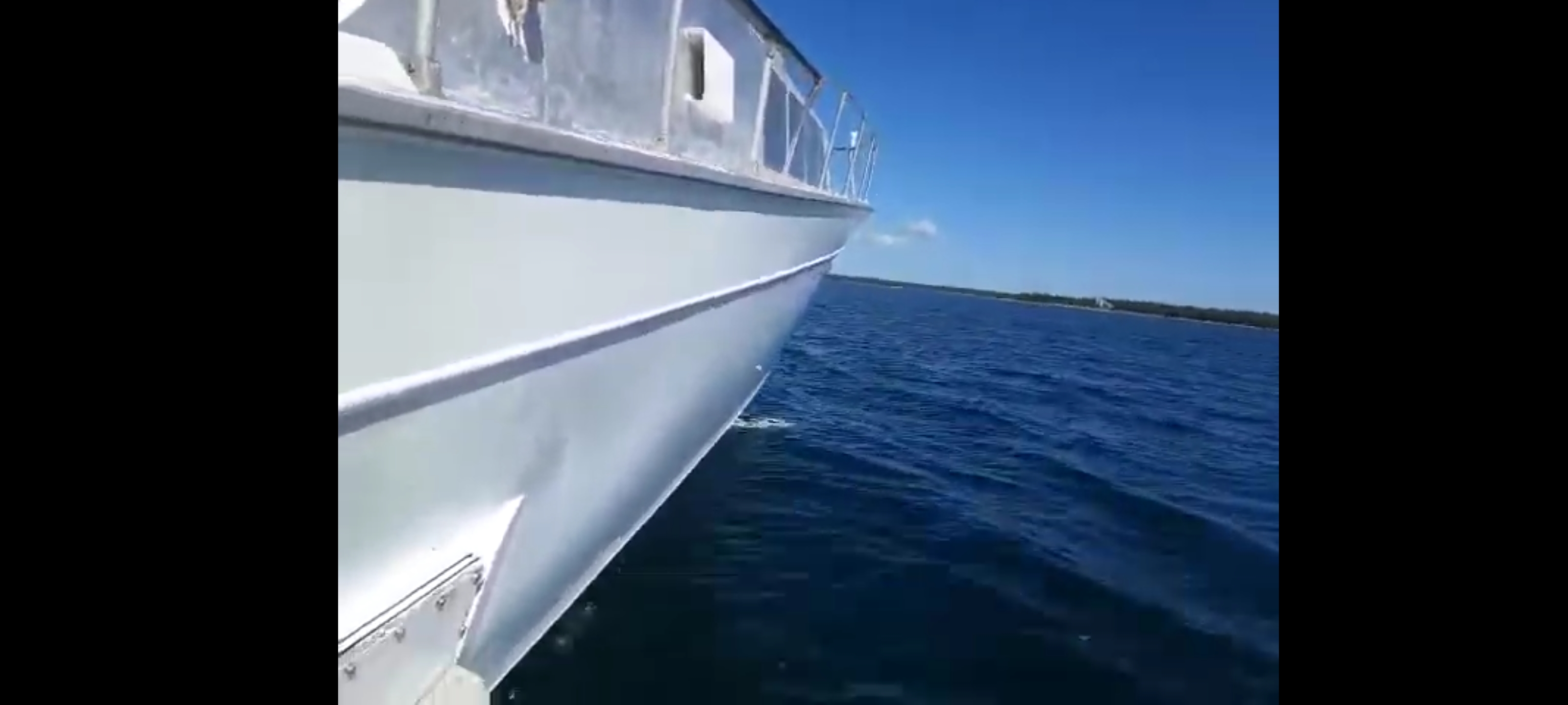

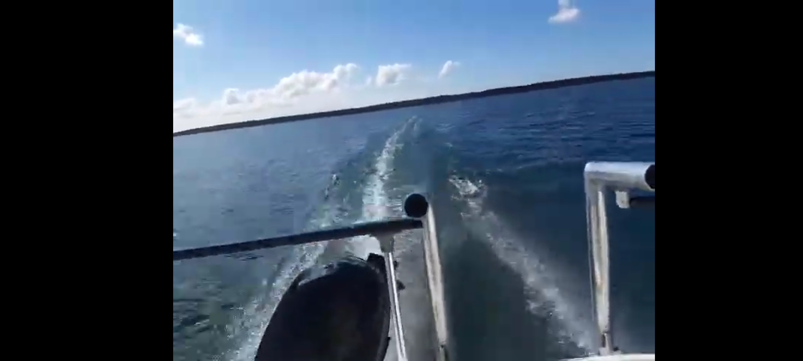

I got out for some tests.  I plan to get one more test day in September, and will post pics then. My boat is a very modified 32 Express. With the Bravo 3, and a 350 mag mpi, I was getting 2 -2.2 MPG at 29 MPH, depending on the wind direction, according to my floscan.
Below : my wake at 30 MPH, and looking forward at same speed.
