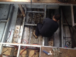

Is there a good way to remove the foil-covered tar coating on the inside of the hull? I have tried pressure washing, strong soap / scrubbing, engine degreaser, and mechanical scraping. Any ideas?

My 2 cents. I know it is a sound damping material, but I don't like it. Smells bad, holds oil. I dumped two large jugs of Dawn dish washing soap in bilge , added water and drove it around for a while. Scraped it up with wide scraper knife. Then used wet dry vacuum to get it out. Didn't get it all but it looks better.

I am restoring the boat and while the engines are out, I want to clean the bilge. A lot of the coating has peeled up already so I wanted to epoxy coat the exposed metal.

I found that a heat gun and a scraper work well. I use paint thinner to clean up the residual bitumen. Next step is acid etch then epoxy prime.
