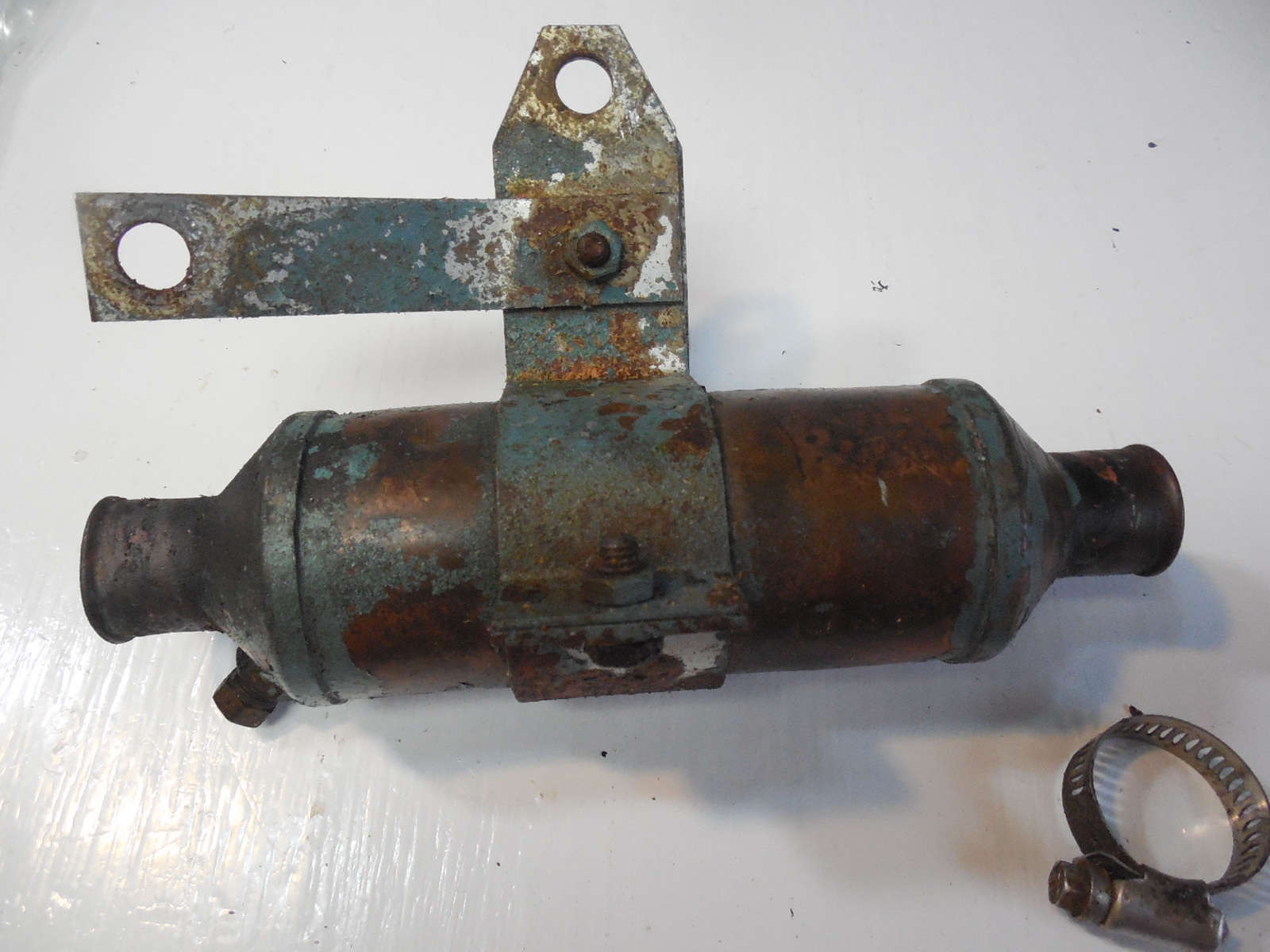

Oil cooler look like this? http://i.ebayimg.com/00/s/MTIwMFgxNjAw/ ... p/$_57.JPG
The fastjeff reference transmission cooler is still on my list to find for my 1:1 velvet drive
Miami FL & Catawba OH
Posts: 905
Re: Hot exhaust and Steam
Tranquilo wrote:Oil cooler look like this? http://i.ebayimg.com/00/s/MTIwMFgxNjAw/ ... p/$_57.JPG
Yep..that's it

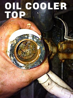

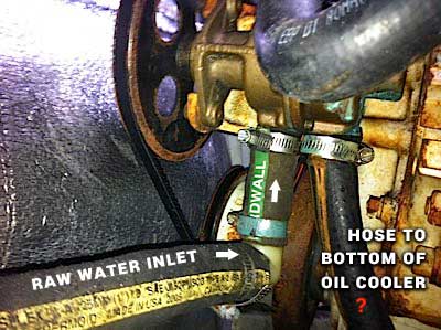

Tranquilo
Posts: 245
Post by Tranquilo »
Wanted to drop an update on my quest for a cooler engine.. I got the oil cooler off and there was a bunch of "rust gravel" on the top side of it. I blew it out with a hose from the bottom and it just came out super easily.
Now the question I have is about the direction of the flow. The block was on the top of the cooler. The bottom of the cooler has a direct hose connecting to the bottom side of the pump. Does the pump draw water through the oil cooler (from top to bottom) or is the pump feeding its water through the bottom and out the top (making that gravel just runoff from the manifold)
Which way does the water flow through the cooler?

jtalberts
Posts: 133
Joined: Sat Jul 12, 2014 7:30 pm
Post by jtalberts »
The side with all the junk is the inlet. That is the direction of the water flow. It fills up that side and has no where to go. The outlet side should have nothing on it.
