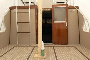

On my 28' sportsman, I Covered the both bow and main cabin wall panels with white Polywall, FRP ceilings and nautolex floors. May not be orginal but sure looks clean!

When I bought this last fall, did not have any wall panels. I did use 1/4 plywood and covered with vinyl. Just need it to last as long as I do.

I used Pollywall over existing panels (no adhesive just polyurethane mahogany trim to hold in place), FRP on ceilings and Nautolex floors
