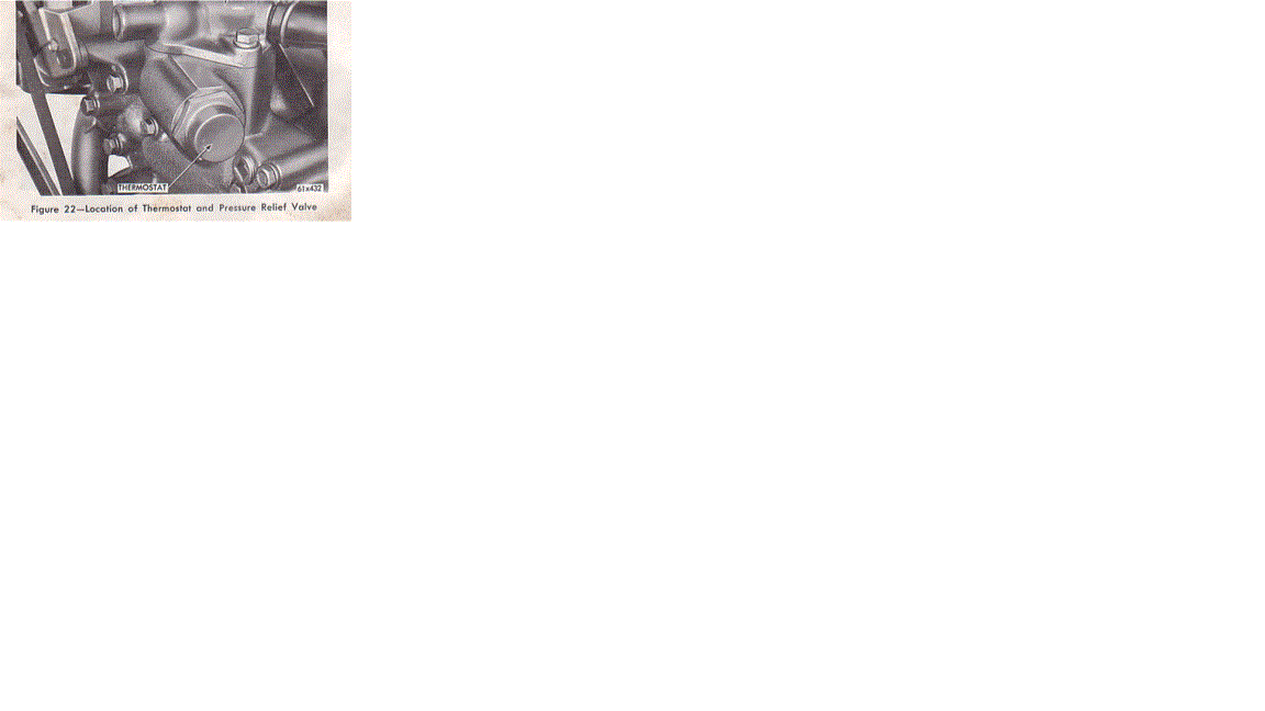

so if you look at the manual for a 67 318 here is what the photo says the thermostat is. The one on top that we would all call the thermostat is called a pressure relief . So my boat is a 73 and only has the odd looking 100 plus dollar thermo but if you seen the post fastjeff made an aluminum plate and a trip to your local parts house and you will be well under 20 bucks. I called Marysville Marine and they confirmed they can no longer get the odd screw in type. ( also found a company making this style but for aircraft and about 350 bucks.) If anyone has any input I would love to here it because we are at the stage of putting the old stuff back in and running it till it breaks.

Re: Where can I get a proper thermostat ?
P.s.
The picture you show looks nothing like the thermostat housing on my motor and I wouldn't think yours would differ from mine..
The photo is of the 67 318 setup . Mine is a 73 28ft single 318 and is the same as yours.
