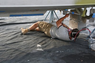

Going to survey/sea trial 37 sedan next week. Been sitting in a marina for a year and a half since the owner passed away. It would be of help to me if I could see some pictures on what and where the hull annodes were on the 1982 37 sedan. Are they in similar location on the 32s, maybe just shorter. I'm familiar with the round ones on the trim tabs and rudders for fiberglass boats, but are they, also, different on aluminum boats. ?? Any pictures would help. Thanks

Are they clear down towards the bottom of the keel? How far aft from the bow at the water line intersection as a reference point? Assume, if they haven't all ready eroded away I will recognize them at that length. Are there studs in the hull that they attached to, or recessed threaded holes??
Re: picture of hull annodes.
Here's a pix when I had the bottom blasted and recoated. the anode is covered in tape so it wouldn't get painted.
Keel anodes are attached to the horizontal (essentially level) portion of the keel, a little forward of amidships. They are thru bolted using stainless bolts. That is through a hole drilled in the keel and the anodes. The keel is scraped clean so the anodes make good contact with the keel. Although some put a stainless washer on the bolt between the zinc and the keel. I forget why.
Hope the photo helps

Great picture and description. Thanks a lot. It will be interesting to see what is on the bottom of the boat in question after being in the water at a marina with no use. When the man bought the boat in 2013 there was a survey and the bottom was painted. He passed away Dec. 2015 and, as I understand it, nothing done since then. Thanks
