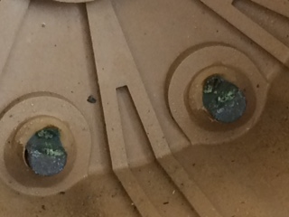

I actually had them send me a new clamp because the aluminum cap clamp fused together. I also had to replace my coil because the terminal rusted (the metal was not marine rated)
Other than the corrosion issues, it runs good after a year. I do see some rough metal in the distributor cap contacts but will send a picture to the guys there to see if its normal or if the coil puts out too much juice.

Interesting that we are experiencing similar observations. No problem with corrosion on the coil terminals here. The STB cap looked like every contact was hit with an arc welder leaving what looked like slag. No so on the Port which only had very light corrosion and no evidence of arching.
Even with the OEM Dist. I always have had a moisture issue on the STB.
Going to replace both caps and rotors so even playing field again this season.

Dave this is what I sent to Roger. I really think the new Distributor they have will help this problem.

Yup looks like mine!

Too much gap between the rotor and cap and/ or improper timing of when the spark happens relative to the rotor/ cap interface (not engine timing).
It looks like the spark happens off to one side a bit from the photos.
