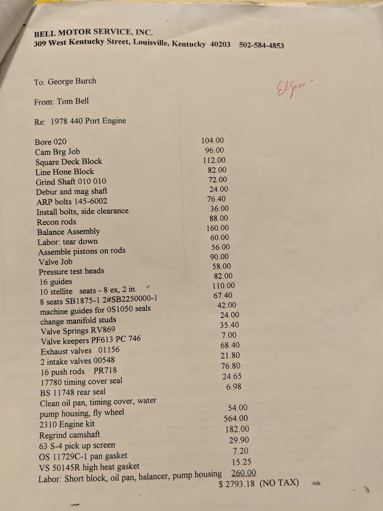

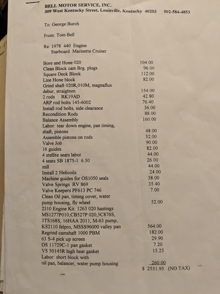

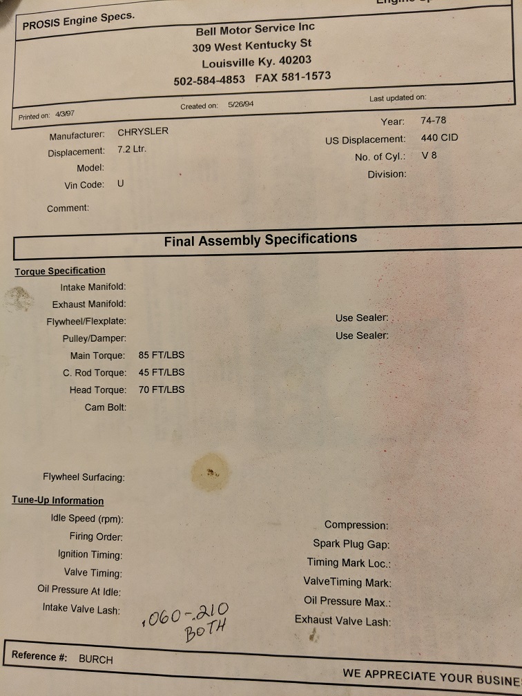

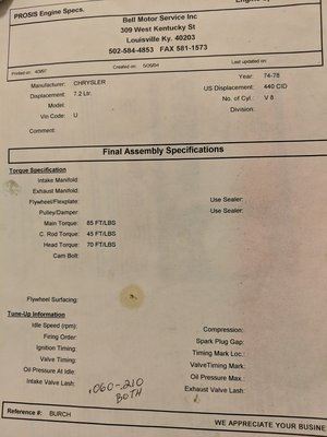

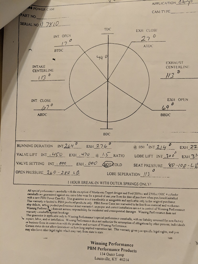

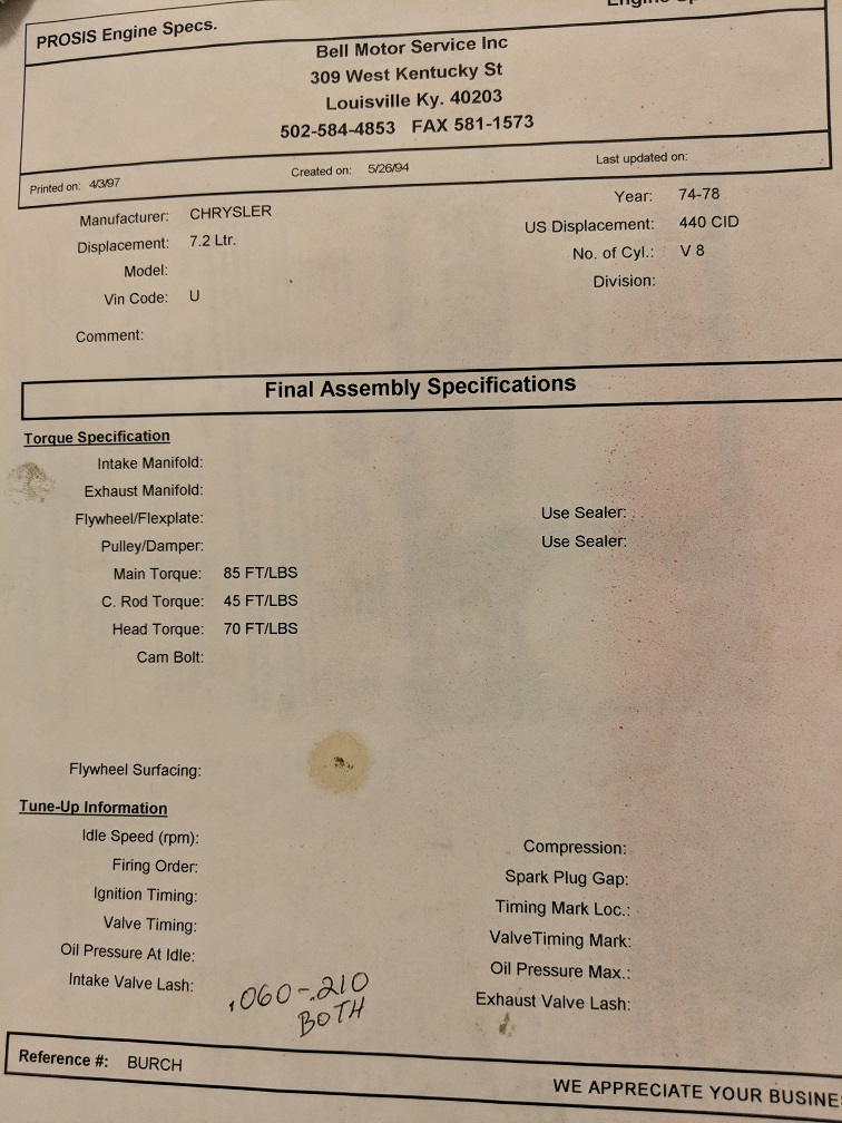

legendlc
Posts: 181
Re: engines seem locked up
Post by legendlc »
Not sure if this helps but here are the rebuild specs.
