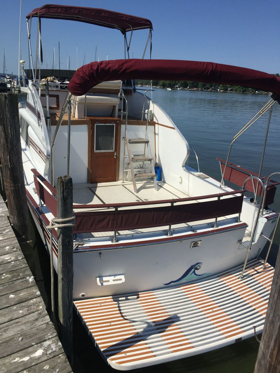

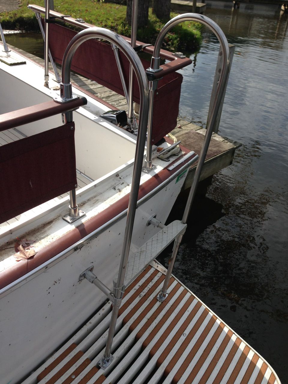

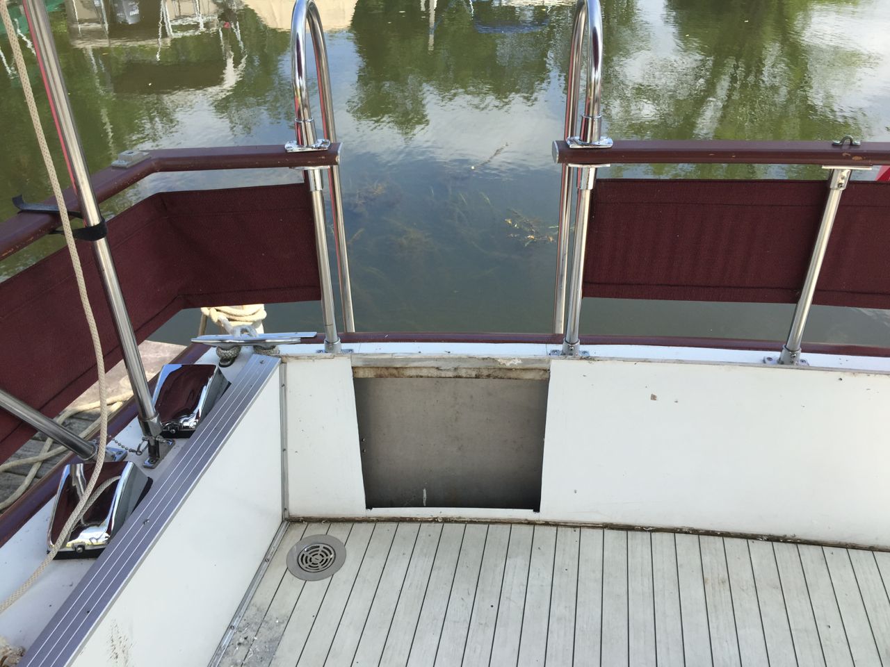

I posted a few pics on a modification about a transom gate and larger swim platform and several readers asked for some details so I thought I'd start a thread for anyone interested in the topic.
The boat is a 1982 28' Sportsfisherman with twin V6 165 HP Crusaders. It is used for day outings with the family and fishing. I wanted better access to the water and lifting little kids and a yellow lab over the railing got old real fast so I came up with a solution. Cut a gate, add railings and larger swim platform. The swim platform was made by plasTEAK outside Akron, OH. It is made of recycled plastic. I made a cardboard template off the old short platform and simply extended it and sent them the form. It is aprox. 101.5 in. by 34 in. They have different colors to match your boat. https://www.plasteak.com. (I also used their sister company products for the flybridge deck and cabin sole. PlasDECK.com) The cost was $1380.00 and $245 for the under mount stainless ladder. I hired a local welder to remove the old platform and build braces similar to the original structure but with longer angle braces. The ladder and transom gate was added later. First the ladder with a temporary step. I bought the railing and hardware on line and a local machine shop made the bends. It was then just a matter of cutting the railing to length and mounting the hardware. The gate was also rather easy once I made sure all the cuts were aligned correctly. First I cut the inner panel, using a T square to make sure the cuts were vertical. Then again using the right angle guide to make sure the outside cuts were parallel to the inner ones. Drill a hole in the lower corners and I used a battery powered DeWalt Sawzall. I then sealed off the gap with high density 1/2 plastic boarding. Similar to a plastic cutting board, but any material would do. I used some 3/4 inch aluminum angle stock to mount the plastic. I was thinking about replacing the plastic with aluminum to keep with the Marinette theme. I have some of the board left and have some stainless hinges to make a gate but.....now it's boating season and I don't want to work on it with a drink in my hand!

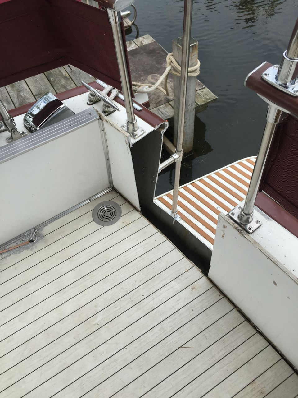

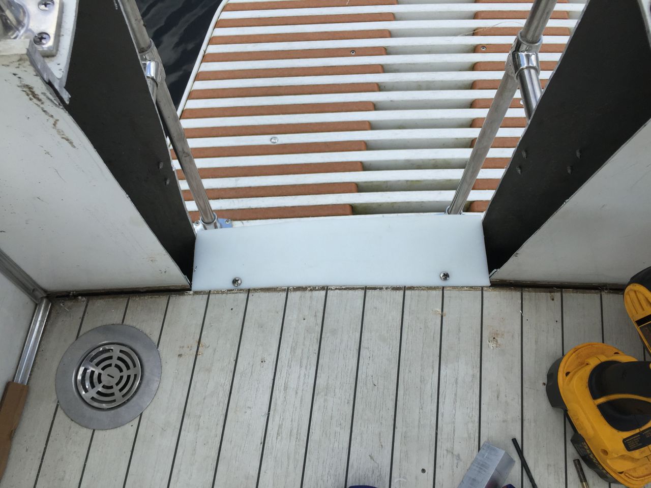

Piedmont Plastics quoted me $980.00 for for a solid piece of 1"x4'x12', Starboard-textured, and somewhere in the $300.00 range for CNC Routing. Would have to modify my current supports if not replace, wheels are turning. Have you filled the openings in the transom?

Are you referring to the vertical openings? Yes they are filled in with the same plastic as the deck opening, I just don't have a close up pic of the finished project. I have not made the gate yet. I have the material and hinges but I try not to do projects during the season. My boat time is limited during the season so I end up just enjoying the weather and a cold one!Tuggle wrote:Piedmont Plastics quoted me $980.00 for for a solid piece of 1"x4'x12', Starboard-textured, and somewhere in the $300.00 range for CNC Routing. Would have to modify my current supports if not replace, wheels are turning. Have you filled the openings in the transom?
For the price quoted above you can have one made from PlasDECK. The supports would have to be redone. I suppose you could just mount the new platform on top of the old one but that would still need some angle supports. I wanted mine close to the water. Iwas concerned that it would hit the water when getting up on plane but it clears nicely.
I can say without a doubt it is one of the best modification to these boats. I can take some additional close up pics this weekend and post them for anyone interested in modifying their boat.
