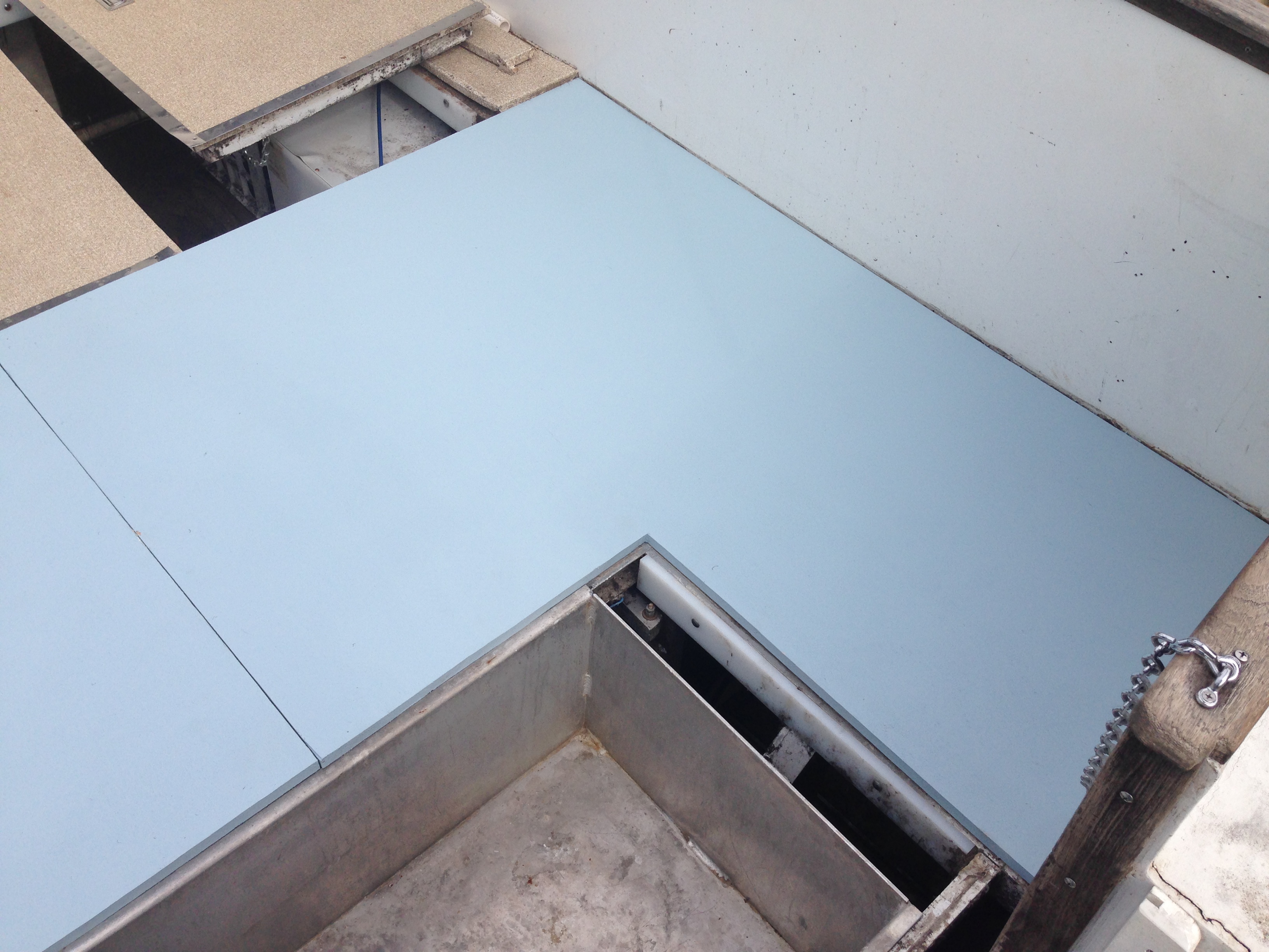

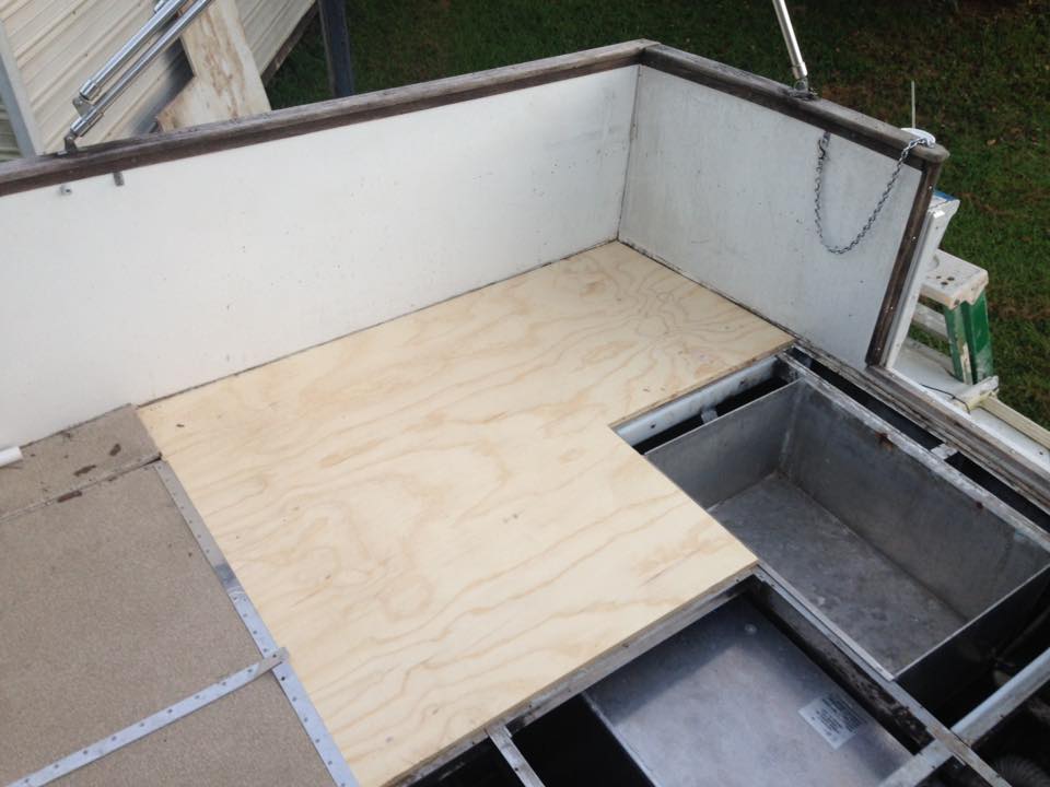

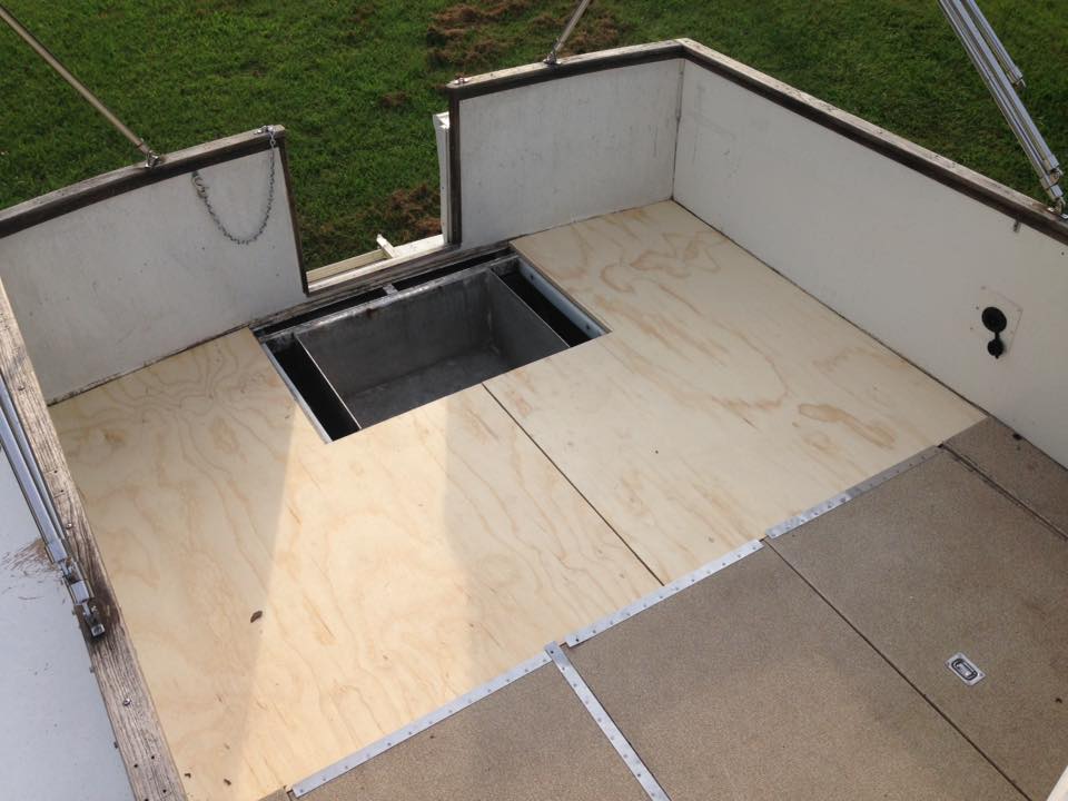

My 85 Sportsman was refit by someone in 1998. The floors were replaced with 3/4 inch marine/waterproof (Not treated) plywood and I recently replaced a few pieces of that flooring in the cockpit. I am experimenting with using Olympic Rescue IT as it has a non skid built in.

Stainless is really your only choice for mounting. As for the deck, use as few screws as possible. I have planned to use a small (note small) amount of double sided tape as well on decks that do not come out often. The decks I replaced recently had it on all seams and it was a bear to get the floor out!

I had my cockpit deck pieces sprayed light grey at a Rhinoliner dealer overlapping the backside 6". Then I painted the underside with white porch paint. No need for expensive 5/8" marine plywood. I stained and varnished luan with a nice figure to replace the delaminated salon panels on an earlier project. Again porch paint on the backside. The best advice I can give is not to tear up the whole boat. Get it running first and put it in the water. Then do one project at a time keeping the boat running. I see too many project boats that have been taken apart and never put back together. If you are going to have a holding tank for waste make it plastic. Acid in the waste will eventually eat up the original aluminum tanks.

Metal Head - what do you use that metal box for that looks like it is welded into the rear deck storage hatch? That is a good idea. That space on mine does not get used for much right now.

Re: 1985 Sportsman Restoration Beginning
Metal storage box - Rope locker, aka junk box
