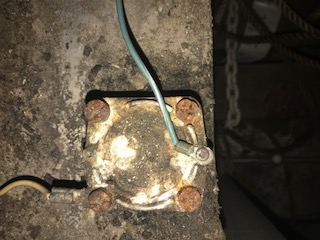

Now on to my question. My fuel sender isn't working and I would like to replace it with a reed switch sender. I am told that the mounting pattern is odd and that it is a hard part to find. I am going to try and attached the picture I have. Assuming I can upload the picture, does anyone know where I could purchase a new sender with this bolt pattern? If not what option should I explore to address this? Weld a patch on the fuel tank and install a new sender?

Square Mount Fuel Sending Unit

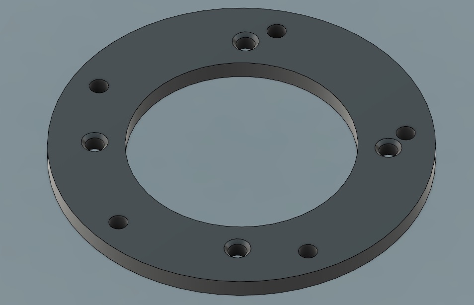

You may be able to have (or make) an adaptor from a thick piece of aluminum.
Like this maybe?
Like this maybe?

Thanks Metalhead. I Will explore this option also. I decided to work on the engines/fuel tank next instead of spraying the last two coats of topcoat. I figured it would be easier to repair the paint if damaged during engine removal at this stage.
