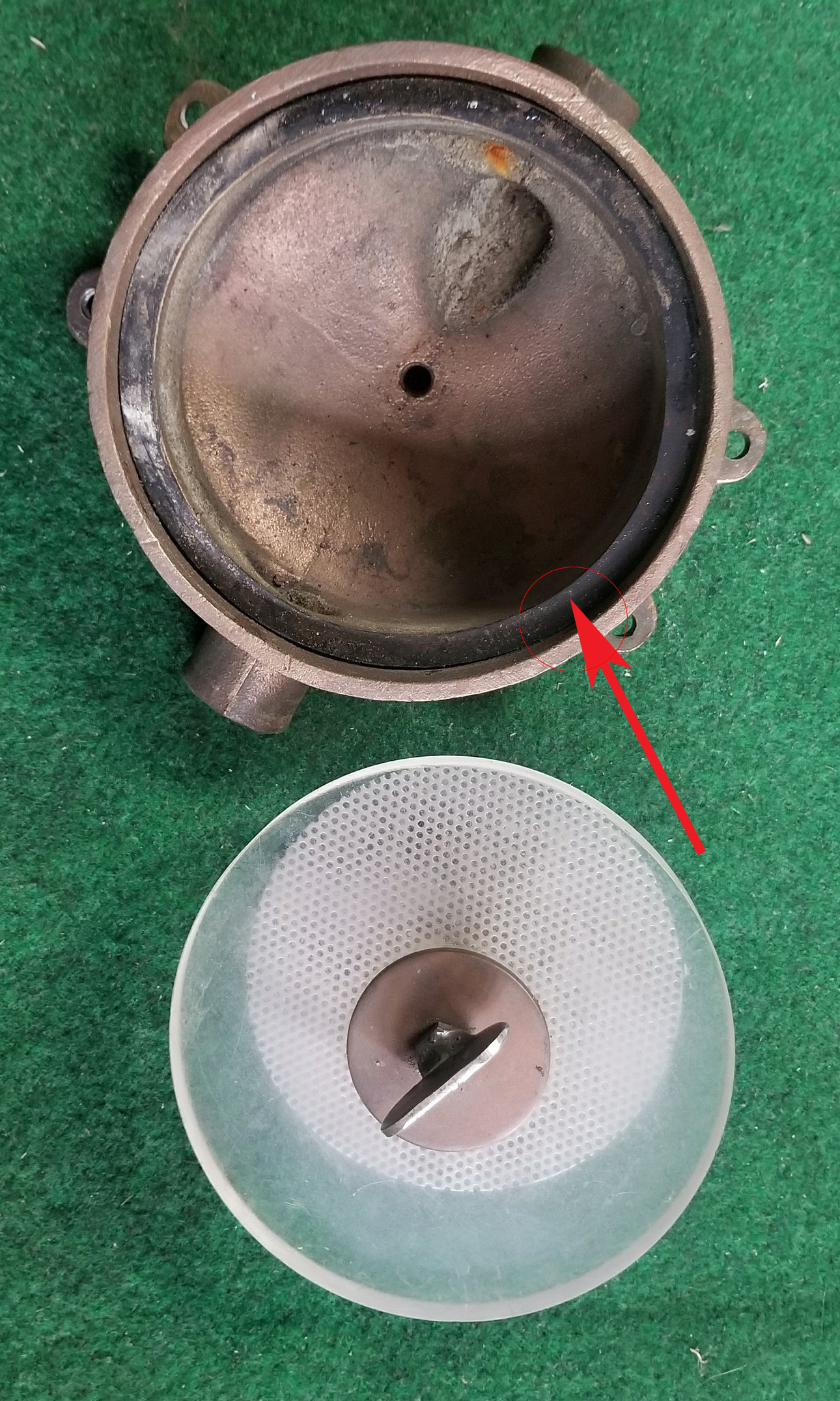

Thank you for the replies! I did buy a sheet of cork/rubber from autozone to cut the ring. I was expecting this to be a large diameter O ring sandwiched between the cap and the brass (but, I honestly don't know). Now, I don't know what/where this o-ring will be - i thought it was this big gasket indicated by the red arrow.
And, I don't understand the hose/wire/contact cement process, but might once i dig in. if you're using vaccum hose, that's not very big. any additional help?

jennis9 wrote: I don't know what/where this o-ring will be - i thought it was this big gasket indicated by the red arrow.
Just to be sure -- it's a gasket (flat seal), not o-ring (tubular) that you are going to replace. And you have correctly indicated the place by the red arrow. An o-ring might work but the flat seal would be better, I think.
You could home - make something and it would probably work but the proper gasket, though a little over-priced, will probably last years and will keep air out of the system. And, yes, be careful it's properly in place or it will get sucked into and clog the water flow.
Re: Gaskets for San Juan Bellingham strainer
An O-ring works just as well as that square gasket and tends NOT to fall in on you. On my homemade, I rubber cemented the wire that I stuck inside the tube ends and pushed the pieces together. Piece of cake and they worked perfectly for years.
PS: My homemade O-ring was a bit thicker so, being anal, I shimmed the screen at the bottom down with a flat washer to compensate. I know...

I found my San Juan strainers were hard to seal because the shelf or lip where the gasket sits had depressions or casting irregularities in it. I bought some underwater sealant, put it on the strainer seal surface, covered it with wax paper and reisntalled the plexiglass top on the strainer. After the sealant had set, I removed the top and wax paper, trimmed the oozed excess sealant away, reinstalled the gasket and top. Never leaked again.
