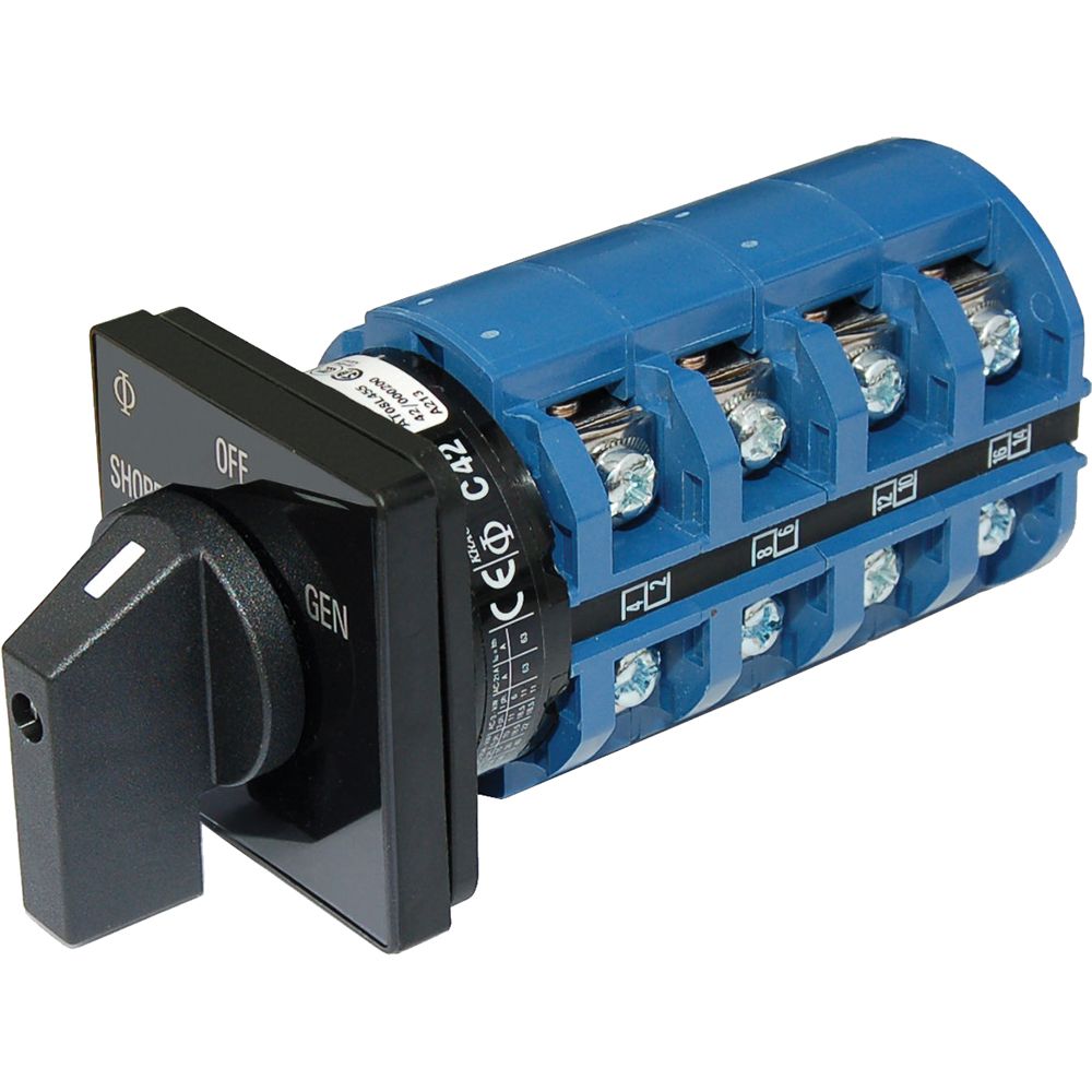

On our 1986 39 Sedan, there was a stern shorepower plug in set added recently by the PO. So it has dual 30A plugin's up front at the bow seat and dual 30A plugin's in the rear cockpit. They are connected at a "Blue Seas" brand switch that has bow - off - stern options. AC power is also tied in with the newer Kohler 7.3 generator. The genny works when the switch is set to the bow position. I assume there is some sort of transfer switch tied in with the genny and AC panel somewhere.

This is the switch:

This is the switch:
