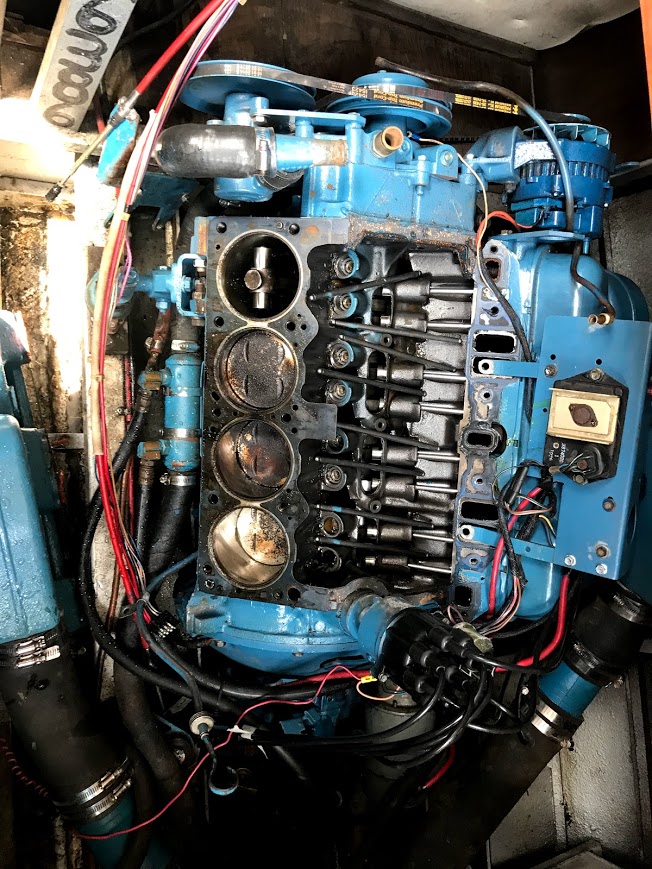

Well after taking the head off it wasn't the valve. It turns out the valve dropped into the cylinder and destroyed the piston. I have to pull the engine and ship it back. At least Rapido Marine is going to send me a new long block to replace what I have but I will need to do the labor. When I pulled the head the #1 piston was gone aka pieces are in the oil pan. This sucks! Nothing like getting to do the job twice

Looking at your picture, I think you need to measure the diameter of your push rods. If they are bigger than 5/16" diameter (.290" is factory), then that is most likely the cause. Some rebuilders like to put 3/8" diameter push rods in rebuilds, and what happened to yours is usually the end result. Look for wear marks about an inch below the top of the push rod. If they are oversized and have the wear marks, check the other engine too.
Because the lifter and pushrod are at different angles, the pushrod rocks back and forth in the clearance hole in the head. There is not enough room for oversized pushrods to do this. They bind, hold the valve open, and bang. Bad day.
Also, is that your reverse rotation engine?

Thanks for the info, I will check that on the next engine. And yes that is the reverse rotation engine. This really stinks as I am not getting re-embersed for the labor, good times! This sucks as this was not a small job as you know!

I can't see clearly in your picture, but it looks like the notches on the tops of your pistons (not the valve reliefs, but the small notch to show installation direction) are facing the front of the engine. If they are, the rebuilder installed the pistons backwards.

Looking at the pic. The head gasket between the two center cylinders looks very black . The firing ring looks burnt to me . Was it running hot.
