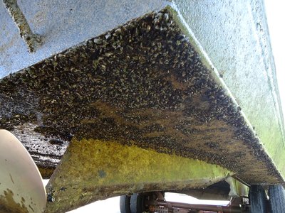

The best speed enhancer if that's what you're trying to achieve (and you should for your wallet's sake) is a clean bottom, free from algae and barnacles. If that paint does it well (discourage growth) then it's ok. What I have encouraged on the board is to do actual comparison tests and see what works - even if you have to lay out a few bucks extra. For instance -- you hear the praises of brand x vs brand y. Buy both in smallest quantities. Paint it onto test strips that you hang from your dock (or both sides of one strip). You'll know in a few wks which one works better. Post the results on line here (with pix would be nice). If you're frugal you could put both on the boat to use up the excess for a season then go to the better brand the next.
My case: I had been using brand x for a few yrs because it seemed to out perform brand y and there was the persuasion of advertising. So I ran (or maybe re-ran) the test. Brand Y had reformulated and the difference was stark. A fair amount of barnacles on the X strip and hardly anything on Y - I switched.
