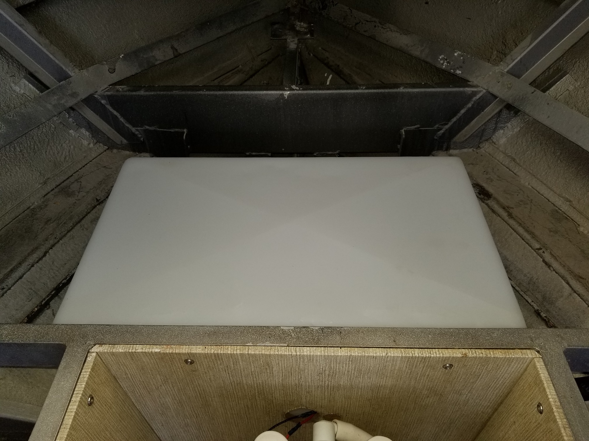

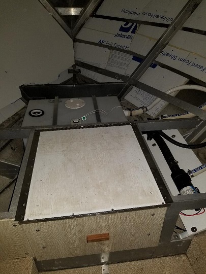

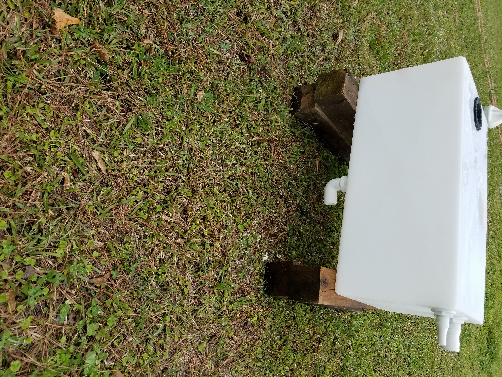

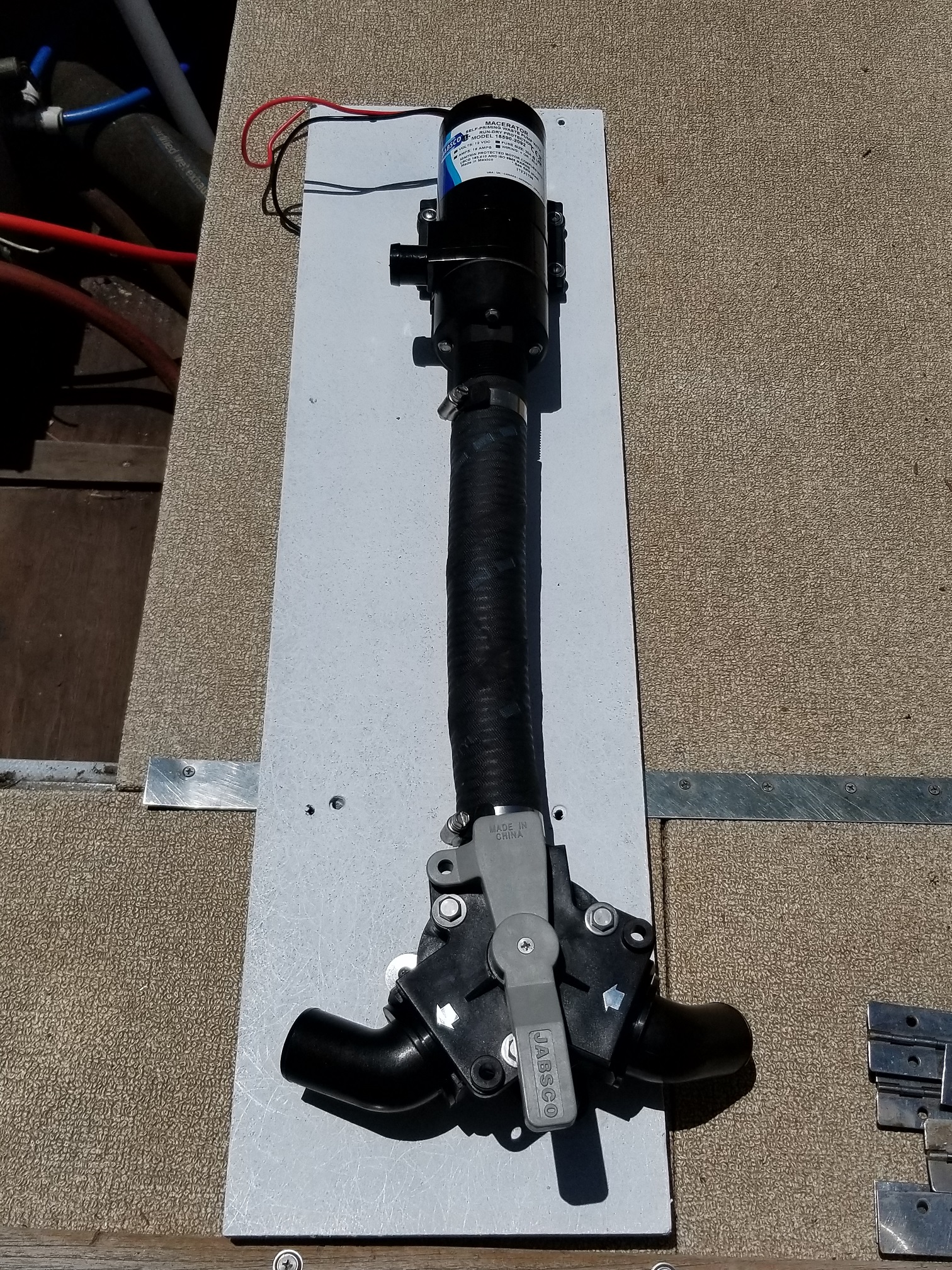

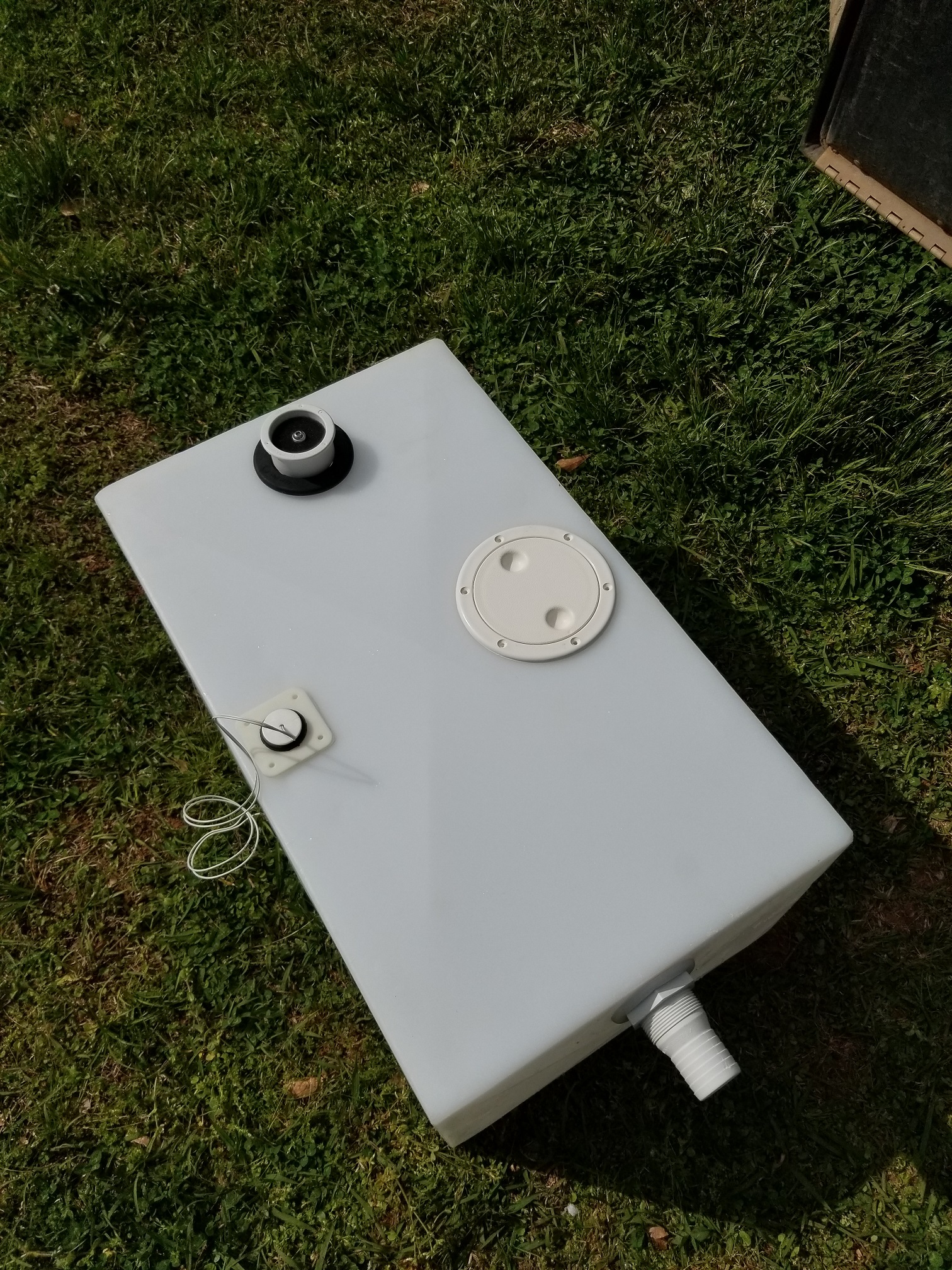

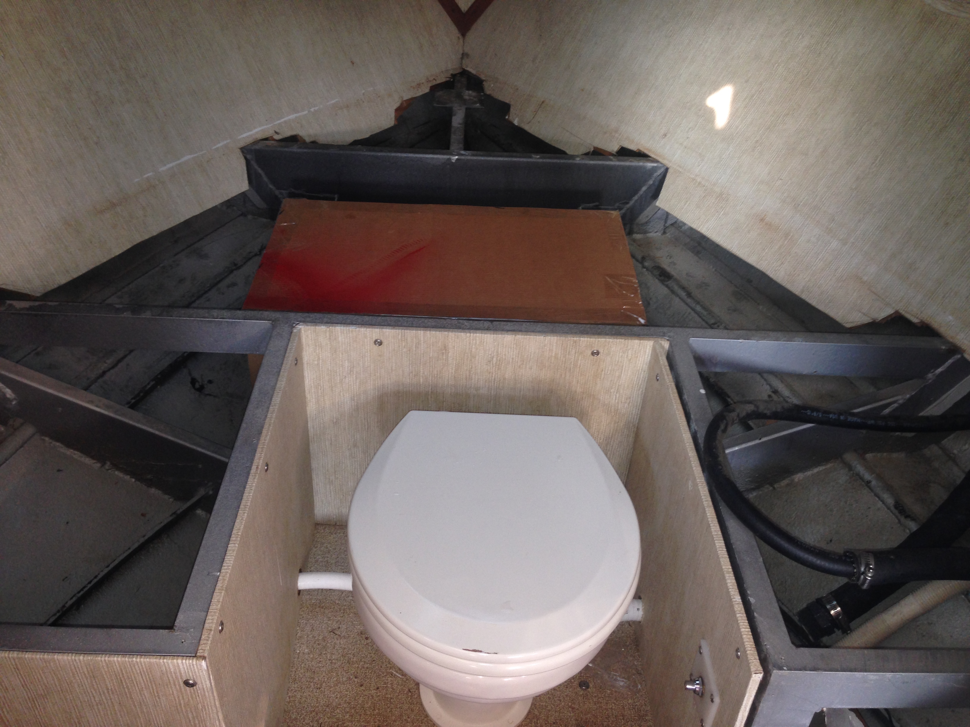

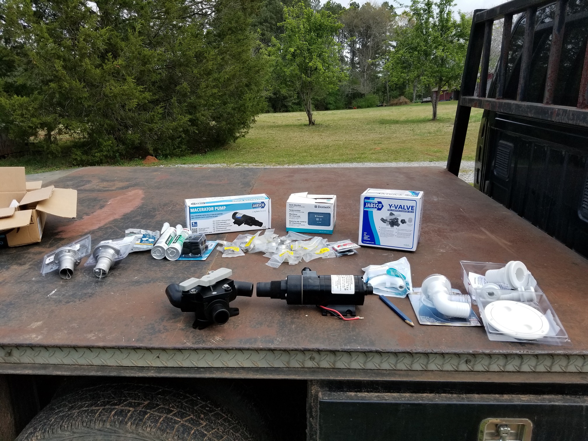

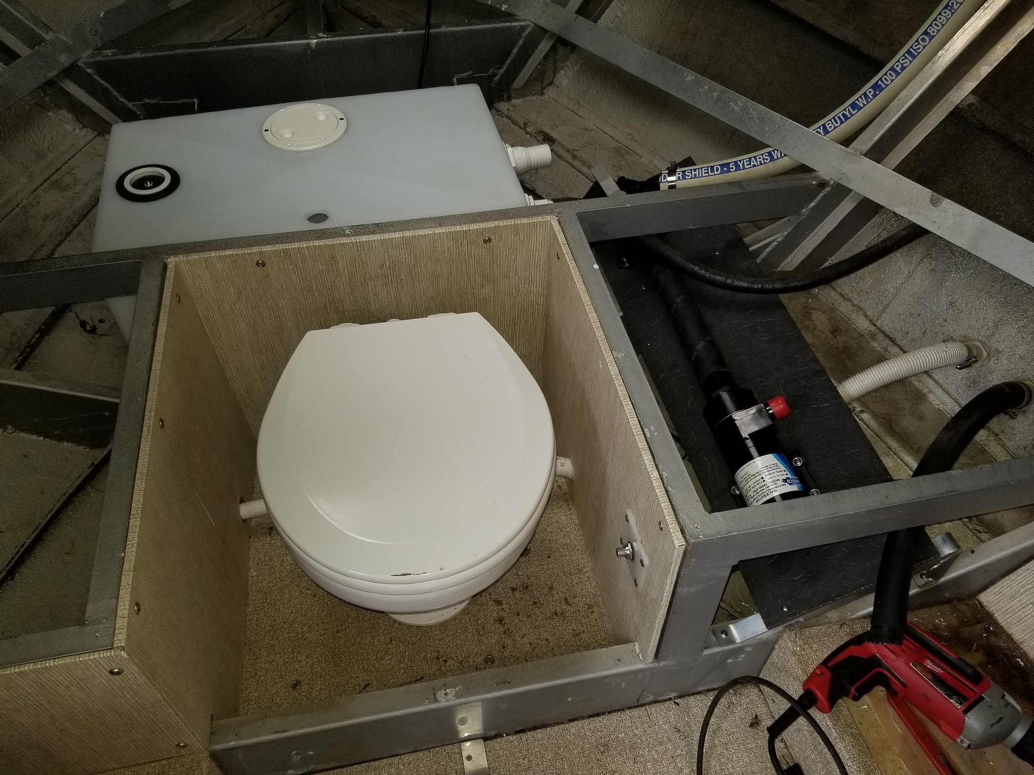

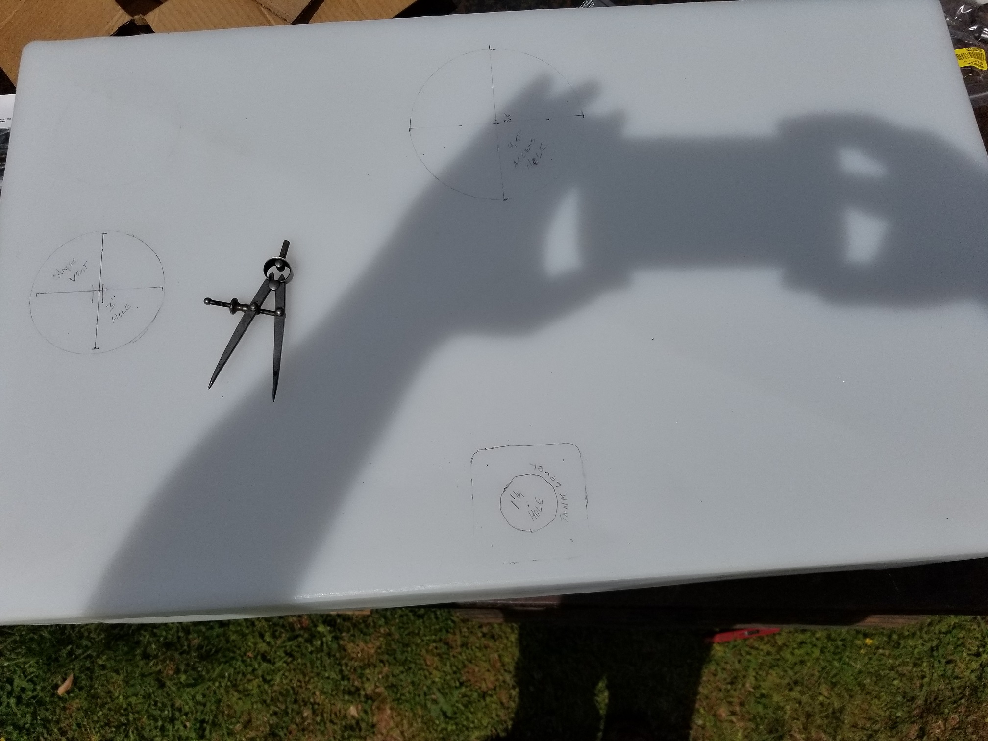

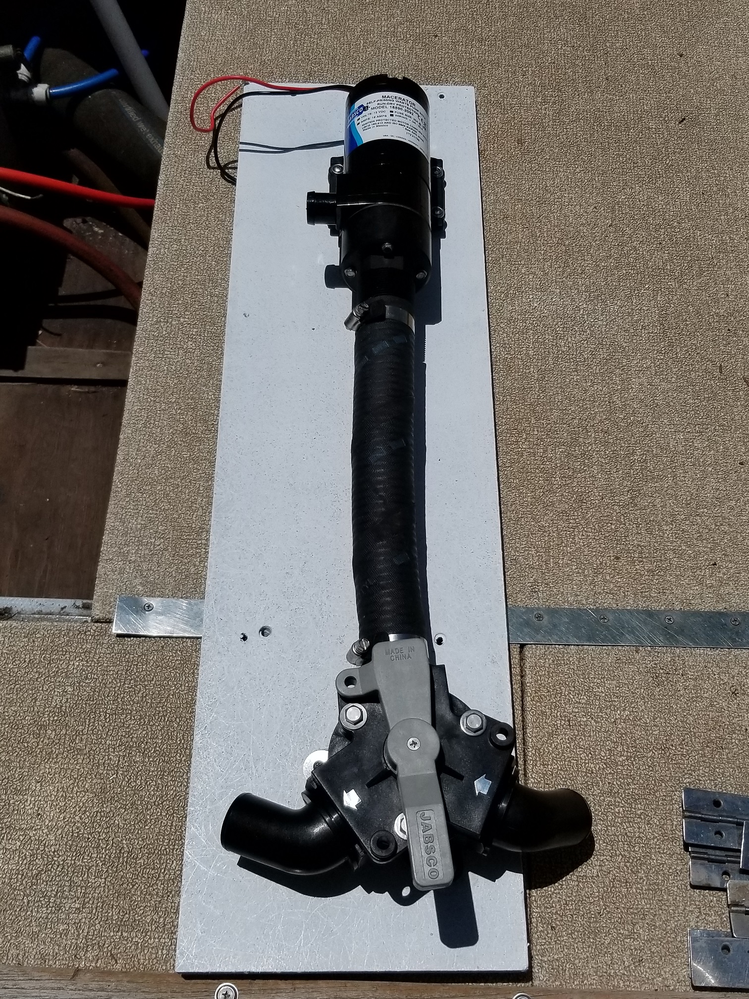

Here is a few of my 15 gallon tank install.

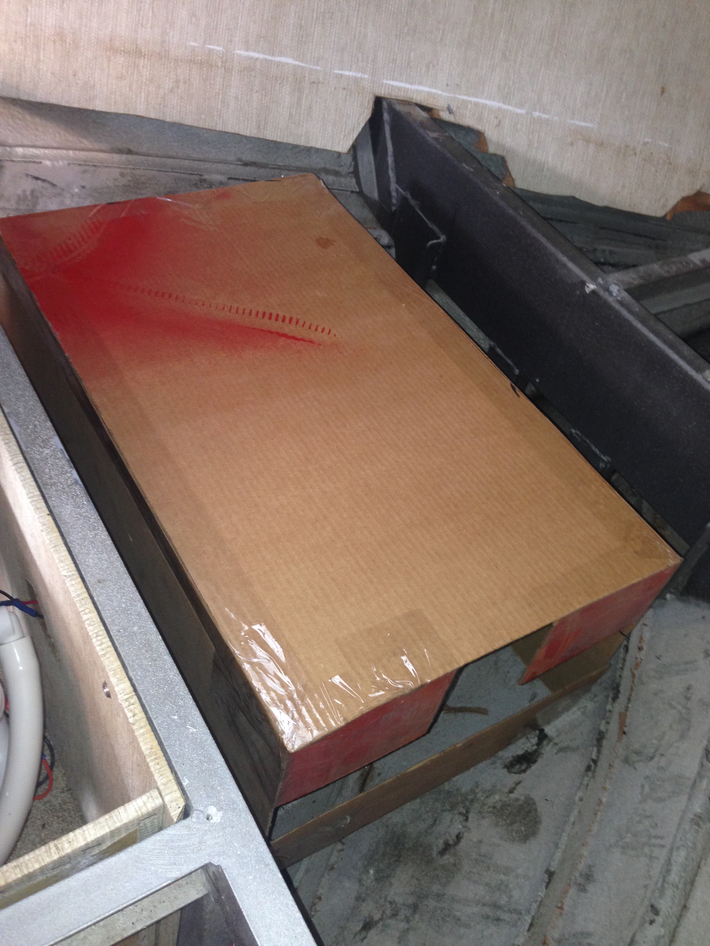

Key step is to card board template the area to see what tank will fit.
