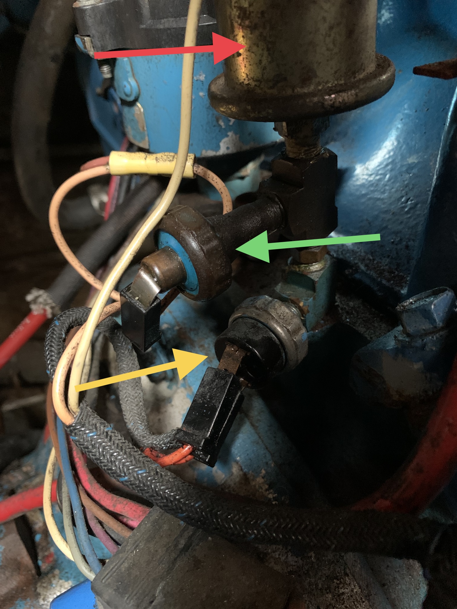

I had one of those horrible pressure switch failure and poured a gallon of oil in the bilge before I noticed it. No apparent damage to the engine as I shut down immediately ( but that oil just pours out fast). Over 2 Marinettes, This has happened at least twice.
I am wondering if I can eliminate one of these switches ( the one with 2 spade terminals). It is unclear to me what that does. I have one wire alternators, and the switch doesn’t shut anything down I can see.
Without it, I get correct oil pressure readings at both stations, engines start fine and the alarm sounds when they I shut the engine down (with the other one still running.
Picture of the oil sensor stack :
Top - red - oil sender (to gauges)
Middle - green - single spade switch
Lower - yellow- dual spade switch ( the one I want to eliminate)

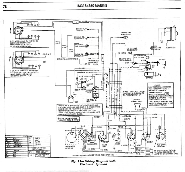

I include the schematic, but it’s unclear what this does.
Any thoughts?
Any thoughts?

Do you have a mechanical fuel pump or an electric one? I don't see it on the wiring diagram, so probably a mechanical one at least originally.
I had some failures of my original (1970s) mechanical fuel pumps and replaced them with Carter electric pumps. I put a two spade oil switch in line with the fuel pump power supply to shut it down if the engine lost oil pressure, as in if the engine wasn't actually turning. The thought is to prevent a different kind of disaster.

i just posted a video on YouTube on this issue, go to my "Jeepmanking" channel to watch. The one wire sending unit switch goes to the alarm buzzer only, the two wire oil sending unit is the trigger wire that tells the alternator to start charging, and then the oil sending unit that has the dome style shape goes to the oil pressure gauges. The buzzer one wire sending unit is normally closed and will open when oil pressure builds and thus turning off the buzzer or light whatever you have on your boat. The oil sending unit that controls the buzzer one wire, and exhaust riser sending unit are in series along with the other engine if you have two engines. I would like to separate the circuit and have each engine sound a alarm along with a additional idiot light so I can see what engine has issues without looking at the gauges.

For One-Wire alternators I don’t think that 2- spade switch is required, as you only connect the alternator directly to the battery. I will trace the circuits when I get home next week, but I suspect I have a hanging open circuit from the old 2-wire rig (is it the orange wire I taped off?)
Do you agree?
(I really want to safely reduce these switches if I can. I am trying to get my bilge clean!)
