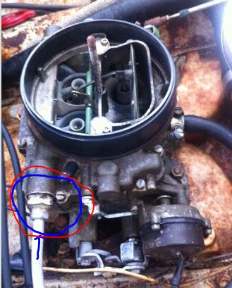

I had the quadrajet with that filter at its fuel inlet point. And it caused the same problems you noted when it got clogged. I attached a marked up shot of yours with the question of whether the Edelbrock has the same filter.

Interesting... I didn't know there would be a filter so small. I'll look that up.

You're running out of fuel. That is what it will do when that little filter gets dirty. Pull it out and blow it out in the reverse direction and you will be able to go fast. Napa or any auto parts store will have them in stock.

Eldelbrock 1409 carb does not have a filter on the fuel line inlet. Airtex is the electric fuel pump I went with it is rated for marine use E8337 check with the tech guys to see what would work best with your tank and line length setup.
