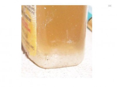

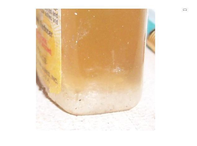

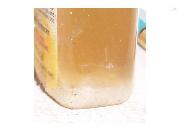

Re: Fuel or Ignition Issues After Warm Up
You might have a carb loaded with "White Gook" thanks to ethanol gas. It will not burn, and goes right through filters (including water separators).
Try this next time you have the problem: Shut off the gas and run the carb dead empty, pumping HELL out of the throttle as it dies out. Open the gas shut off, get her running again, and repeat. Then see if it runs better. If it does, that's the problem. Eventually you'll work your way through what's in the tank, but you may have to do the FERT (Fastjeff Ethanol Removal Technique) a few more times before the "White Gook" i's gone.
