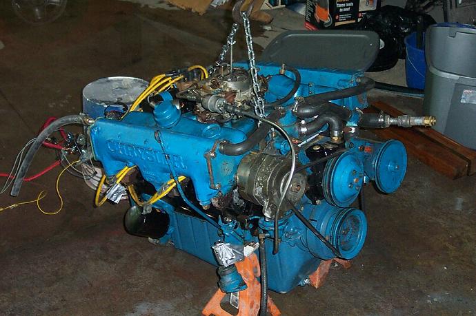

Just a thought from someone who has spent a lot of time attempting to get consumption down on sportfishers. I've noticed efi really only saved fuel at varying load conditions. When identical hulls and power are run side by side at a continuous load, efi and carb setups are fairly indifferent. The art here is truly understanding and setting up a carb. I wonder how long the fuel savings from efi would take to pay for itself. Google water/methanol injection.
Twin Chrysler 318's
